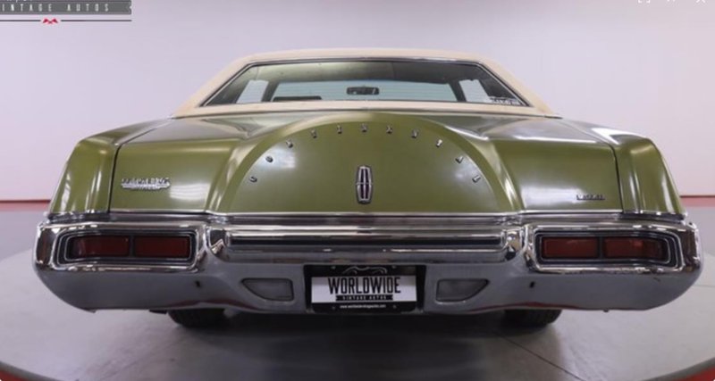

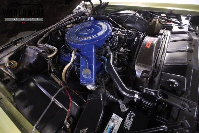

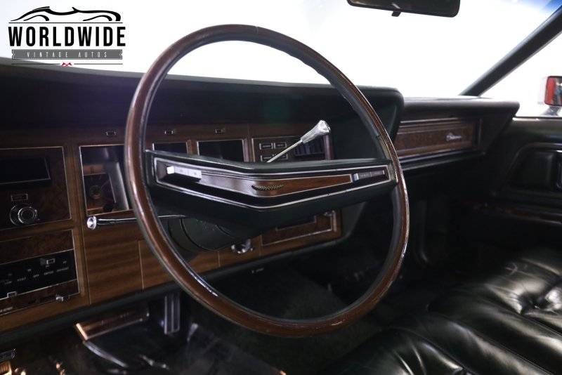

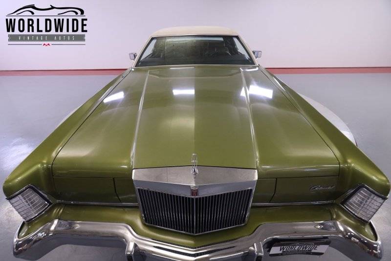

Some of you may remember in a recent post I purchased myself a 1973 Gran Torino as a Christmas gift to myself. Well the lady backed out of the deal after I initially put the deposit down because she wanted more money for the car. I’ve been working on the replacement gift but didn’t want to prematurely share in case the deal fell through again. The car is paid for and the transport company is picking up in Denver tomorrow, so I think it is safe to share. I gave a sneak peak in the other muscle cars you like thread. I’m not sure I want to be referencing myself to Frank Cannon though.

Congrats! Looks like it has a rim blow steering wheel. My parents' '73 Raunch Wagon had one, too.
In all seriousness, I worked on a lot of those back in the early eighties... The heat crossover was always plugged with carbon... That's great on a hotrod motor but on a car like that it means the choke doesn't operate properly & the fuel doesn't atomize properly...
Do the timing chain, pull the intake & have it boiled, replace belts & hoses, new water pump.....
Awesome car. The interior is why you buy anything like that, nothing like it nowdays.

A lot of Ford engines from that era were designed in the late 60's with compression ratio's pushing ten. On the 460, it was over ten. Then, Ford got into the habit for the next 30 years of detuning those engines to make whatever smog limits or whatever other mechanical limits OK on their vehicles. Like the 5.0 Mustang with a T5 manual, the T5 was rated at 300ft lbs, so the 5.0 was detuned to have less then 300 ft/lbs. They detuned their bigger engines to make smog, but also to make the auto trans last longer, at least that was the theory.
I would do the dual exhaust. But I would choose significant mufflers to keep it silent. Not restrictive, just big and quiet.
The best thing for the engine would be to return it to it's "Thunderjet" origins one way or another with compression. Probably with pistons, I doubt there is much to do with factory heads especially past 1970. If I recall right, 1974 factory big block compression was barely over 8, may have been 7.9. 73 was a bit better, a bit.
Ford engines from the 70's were slime pits inside from oil, carbon. Even at that milage, I bet it is slimed up inside. Nothing to worry about of course, but when you get into it be prepared lol.

We don’t get these cars because we are worried about gas milage. :lol: I agree with everything you said above. I’m probably gonna do only a timing set, and exhaust. Maybe a mild cam. Nothing you would notice by looking at it. If its a points distributor probably change that to Petronix. I agree on the mufflers. I was looking at something like this.
