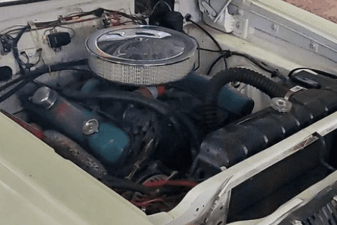

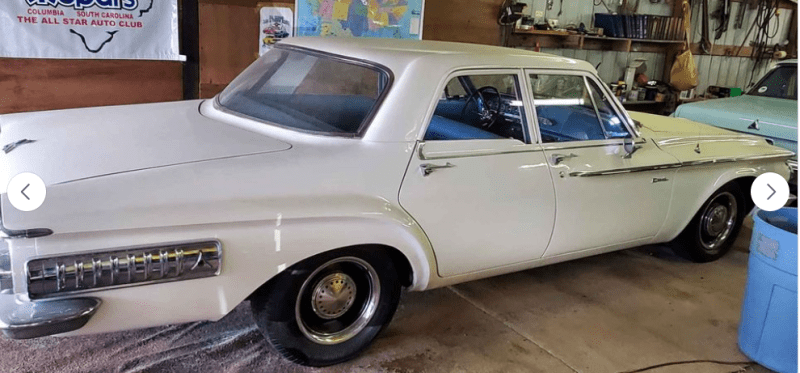

I'm eyeing my first Mopar, my dream car at any rate. It's a 1962 Dodge Dart. Now, some things about this car confuse me. The owner states it is a fuel injected 413 and a 4 spd. No, it is not a MaxWedge 413. The motor more looks like a 361 or 318 carbed motor in the pictures to me. The car is 3 hours from me so I haven't been able to look at it in person yet. From what I have read some did have fuel injection, but a lot were eventually swapped back to a carb setup. Maybe this one used to be and has since been swapped, idk... It's a 4 door on top of that. The side of the car says Dart but the rear quarter "fins" more look like the big rectangular emblem from a Polara. Did any Darts have this on them or did all of the Darts have the molded ripple in the rear quarter and the only the Polara had the emblem looking one??

post the pics you have.. would clear up a lot...
BTW... 318 distributor is in the back.. 361 is a big block with the dist in the front...
To me it looks like a 361 but what do I know.
Sounds like the owned remembers the old song about the the race between "the Fuel Injected Stingray and The 413", and got confused....
A RB aka 413 426W 440 will have a square pad on the block by the distributor about 2x2'' and have stampings/numbers
The B engine aka 361 383 400 does not have this pad.(there are others but we won't get into it)
As far as the quarter molding after 60 years anything could be added or removed.

Looks like two fuel lines back on the firewall going to the air cleaner area. Could be an added after market fuel injection system. Not factory.

Not that it means much but it looks to have a hp exhaust manifold on the passenger side.
