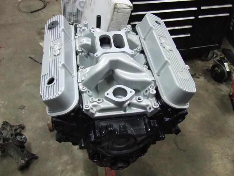

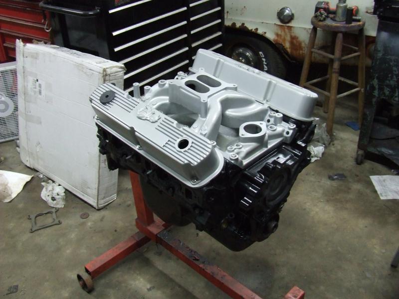

Here is Frankenteen so far. Like I said, it's a budget build so don't laugh too hard.
Oh, I forgot something. You might notice I am running old style valve covers on Magnum heads. The five bolt holes line right up with five holes in the Magnum heads. BUT, unless you use the right gaskets, you WILL have a leak since the heads are indeed shaped differently. Here are the gaskets you need to make it happen.
http://www.summitracing.com/parts/DCC-5249581/
No, they ain't cheap. But, they are the LAST valve cover gaskets you'll ever buy cause they're steel cored and reusable. So far, they are the only gaskets I know of that will make it happen. I credit my good friend Rodney Byrd for turning me on to that secret.

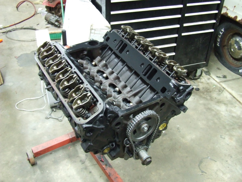

Just so yall know I wasn't kiddin about the stock rockers. lol
Those look like Ford 351 Cleveland rockers. Is that timing chain tensioner stock? Looks like it might me and it also looks like it will bolt onto an early 70's 360.
They sorta do resemble phord rockers......blastphemy that that was. lol
Yes, the tensioner came on all 3.9 V6s and some Magnum motors as well. Yes, it will fit ALL LA blocks. That's what mine is. It's an 83 model, which is the same in the timing cover area as a 273, 340 or 360. Cloyes makes them whether they come in a Dynagear, Cloyes or Mopar box. Dynagear is no more, since Cloyes bought them out. The timing chain is also a Cloyes true roller. Not them cheap split rollers.
