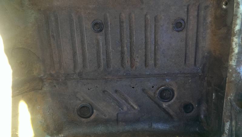

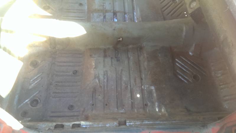

I kinda went against Stevearino's advice, kinda. I got a wire brush for my angle grinder and went to town. It tore through all the leftover padding and any rust in it's way.
Passenger side
Drivers side

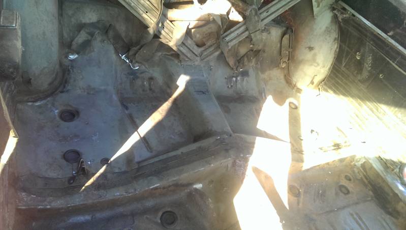

Back seats

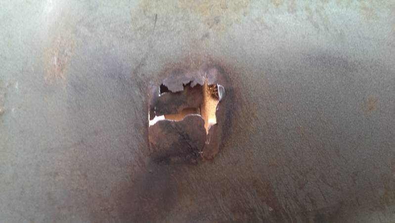

The worst of the rust on the passenger side
Odd hole worn into the transmission hump
Also if you look closely you can see a number of holes punched through the floor boards where it looks like bucket seats were mounted.
How to you remove the metal shields along the door sills that protect the wiring to the rear of the car? I don't see any screws or anything. I'd like to remove them and clean under them before I por-15 the floor.
The car is starting to look really good very solid

All you can do with the metal shields for the wire is just remove by cutting, bending back and forth or however you can. then when you've got them clean the way you like 'em, just tack weld them back in place.
Awe man, I was hoping I just wasn't seeing the screws holding it on. Welding them is no problem, but screws would have been simpler.
that looks good,man you are off to a great start those floors looks good,take your time and do a good job with every section you work on.i would keep as original as i can.

I just drilled out the spot welds on the tabs of the metal shields. Then when you put them back you can tac weld them or you could tap some self threading screws and screw them back on.
Your floors look great, this is one of the cleanest cars ive ever seen when looking at it the way it was when you found it, You have a lot to be proud of and even with the things you have to do ill bet your having fun fixing this old gal up again...
That's gotta make you feel good to find some nice floors. :hello2: Keep after it!

Hell I don't think 1 beer has even been spilled in that car, the pans are too clean.
