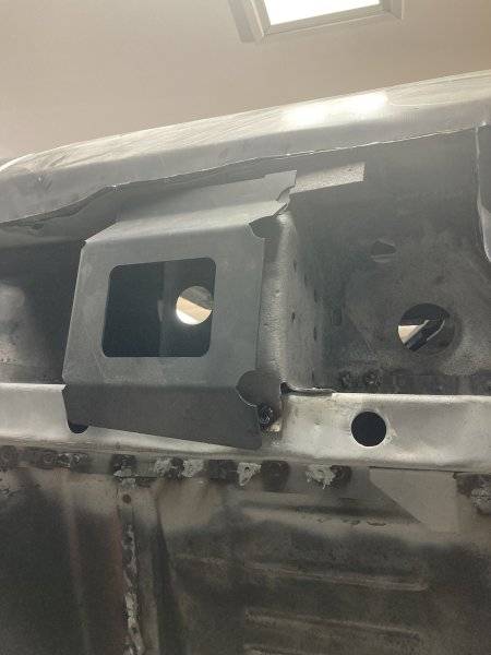

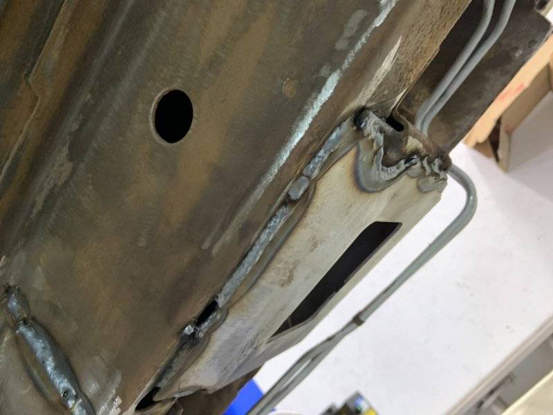

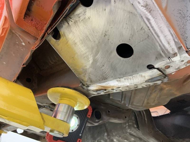

Hi all, I’m hoping someone can help me with a few questions. Is this the way the front and rear torque boxes go?:
Front Driver’s side:
Rear Driver’s side:

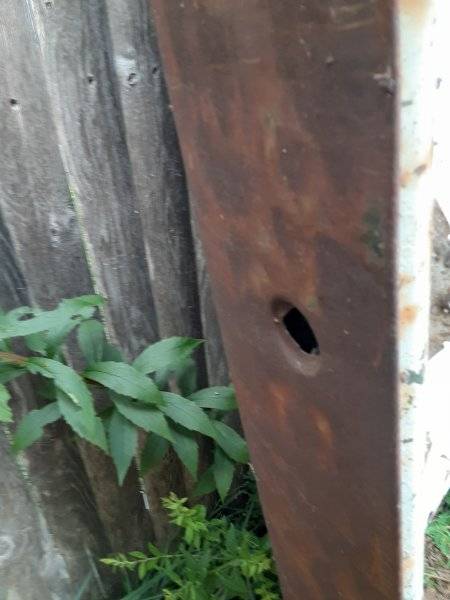

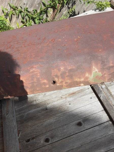

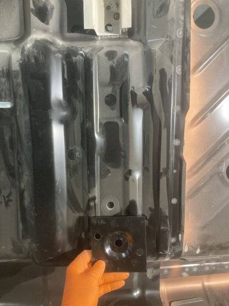

And where do these go? They came with my floorboard from AMD. I’m assuming they’re reinforcements for the seat belts.
There’s a hole adjacent to the torsion bar crossmember:
And there’s another hole closer to the rear seat footwell:
I’m also assuming they go on the bottom of the floor pan and not the top (inside the car). Thank you in advance!
Rear Driver’s side:
Your torque boxes are located correctly. Will take some hammering and trimming to get them to fit correctly. I used the same ones.
The plates look like E-body seat reinforcements that go on the floor. B-body are flat.
I cant help with those torque boxes but I believe those floor parts are supposed to be added if the floor goes into an E body for the seats. The seatbelt mounts are in the rear 2 piece floorpan, like these(AMD).

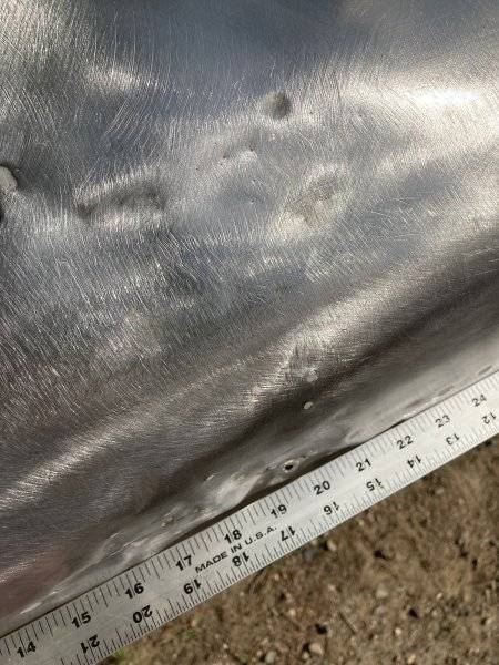

Hi all, it’s been a while since I’ve posted. I haven’t done much after separating my shoulder. I met with a surgeon a few weeks ago and he stated that I should be good to go after 10-12 of physical therapy. My clavicle on the left side will always stick up a bit though. Only having the use of one arm, I decided to try chemical stripping my trunk lid. I knew there was a bit of bondo hidden under the paint but I was not prepared for what I found. My lid is pretty f’ed up. A lot of previous attempts at repairs and some pretty good oil-canning. The lip area on the underside, the area that mates up with the rear above lock, was filled with about 1/2” of bondo running from the driver’s side to passenger’s side. It looks like the lid took a pretty good hit on the driver’s side. I used Jasco Premium Paint & Epoxy Remover first. This worked very well on the primer (top of lid) and the orange paint (bottom of lid). It didn’t do much to the original blue paint that was under the orange paint. And it smells like rotting fish. I then tried Aircraft ULTRA Paint Remover. The last time I used this was in the early ‘90’s on my ‘73 Charger. It stripped the paint off completely, along with some of my skin. This new product smells the part but does not work as well as the original formula. It took about 90% of the blue paint off. I used my Contour SCT to remove the rest of the paint and bondo.

This area of the trunk was packed with about 1/2 of bondo, and is dented in:
Nice patch:
This was bondoed over:

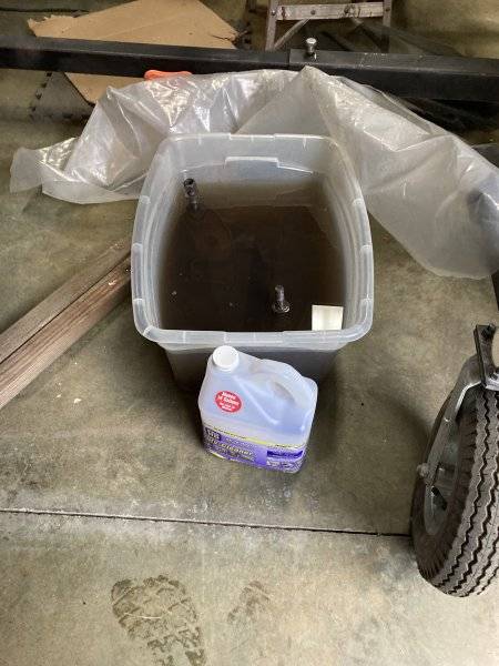

I’m still plugging away on small projects so I can baby my shoulder. I did run a new 220 outlet (with the help of my wife) for a new welder I bought. It’s a PrimeWeld multiprocess unit. Now I’ll be able to mig/tig/stick. I also started cleaning up some of the suspension components. I tried sandblasting the LCA’s with aluminum oxide first. It was working ok but struggling a little because of the amount of grime and crap built up on them. I then soaked them in a container of Simple Green purple heavy duty cleaner for a few days. The crap brushed right off after this and then I blasted them. I have the UCA’s soaking now.

Soaking:
