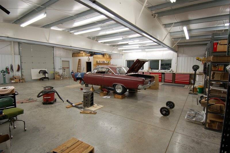

My new, warmer garage!
Yes, radiant floor heat is the way to go if you're building new. It costs me about $100 a month to keep my shop at 65 degrees. Of course our winters are not super cold, we are rarely below zero here and most of the time we are just in the 30's or 40's. I had my shop insulated when it was built and that helps a ton too.

Wow! Nice elbow room! :thumbsup:
What a huge shop and work space, I see the costco gorilla racks...;)
I really wanted to do radiant heat for the floor, and I had planned on at least just putting the piping in but when i went to get my permits I was informed that I could not do it myself and it had to be an engineered system...which meant a ton more money then my budget would allow.
Figured it would be better to get the shop built and finished and not have the heated floors, then to have a partially finished shop with heated floors and no funds to finish it. ;) But the wood stove does a pretty good job heating the shop, and I have wooded acreage so there is basically no cost for the wood, just some time and effort to cut and stack.

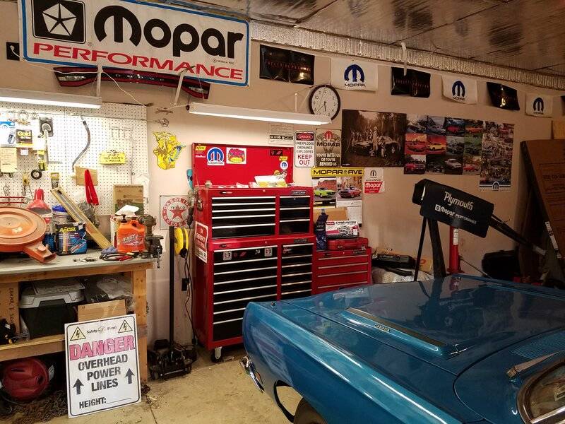

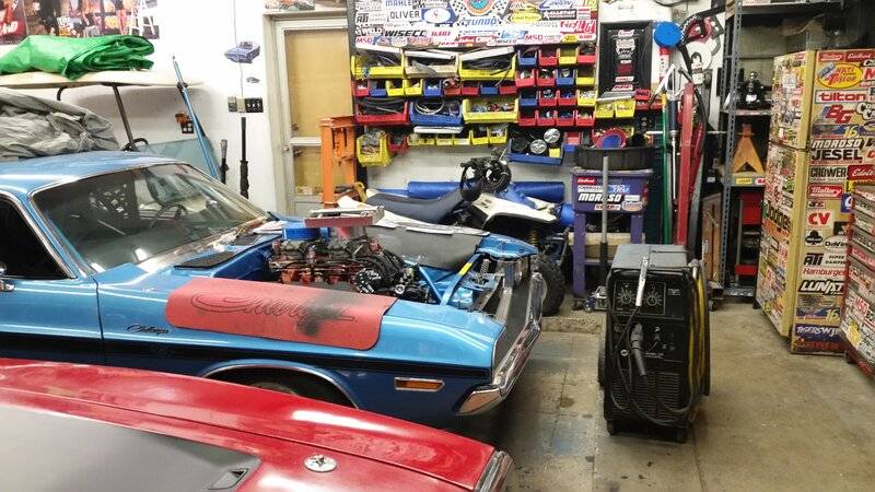

Man, some of you guys have all kinds of room. I have like 5 cars worth of stuff in a 2-1/2 car garage. Need to go double deep someday. I have insulated, dry walled, heated and just added A/C this summer. Man, can't believe I never did the air sooner. It was so nice in the garage at 70-75 when it's 90+ outside. A 4 post hoist is next.
Like me, you need to make do with the space you have. I had an original two car garage attached to my house. If you park two B bodies in there you can fit nothing else (and damn near can't get out of the cars either!). It is small! So I added my "third bay", which is what you see in the pictures in my original post. So it is a 3 car garage that I often squeeze 4 cars into, one under the other on the lift!
But sounds like you are doing OK with it heated and air conditioned! Nice!
