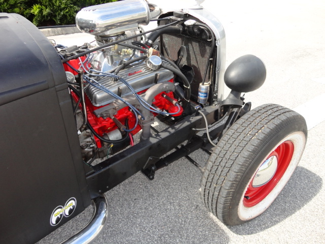

My Newest purchased , not mopar but a bastard adopted step child . 31 NASH rat rod
Freakin sweet, Stuie!! :headbang:
that's da kind of details da olde Nash deserves!!

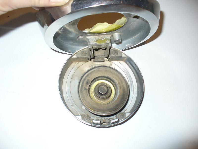

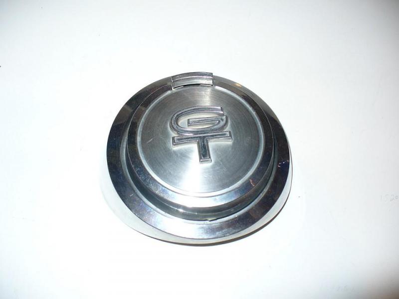

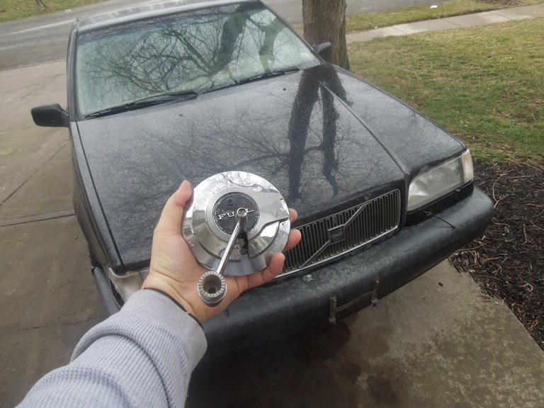

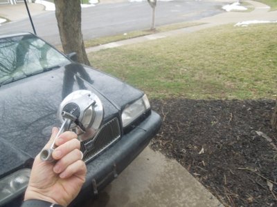

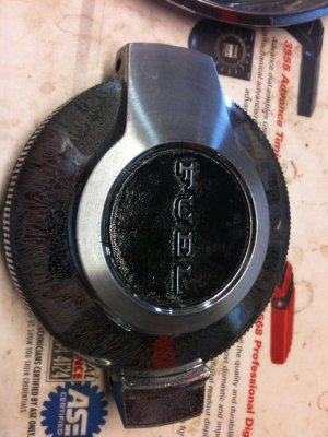

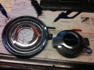

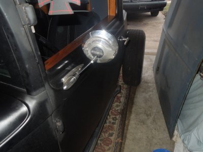

bought this to make a passenger side door mirror out of

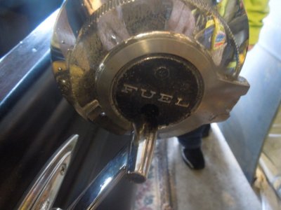

the drivers mirror will be a charger flip top

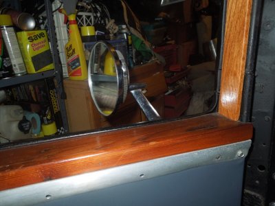

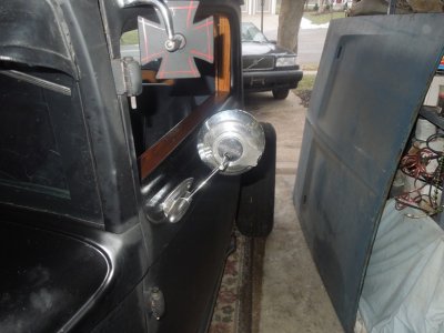

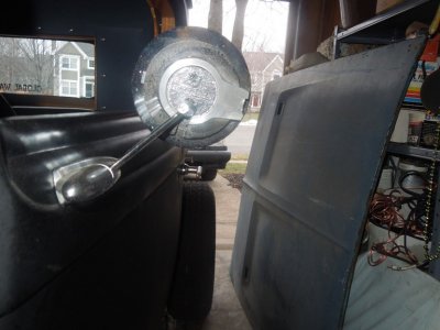

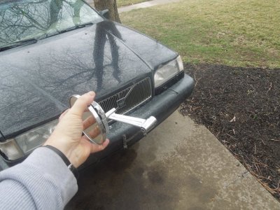

so i put the driver side mirror together

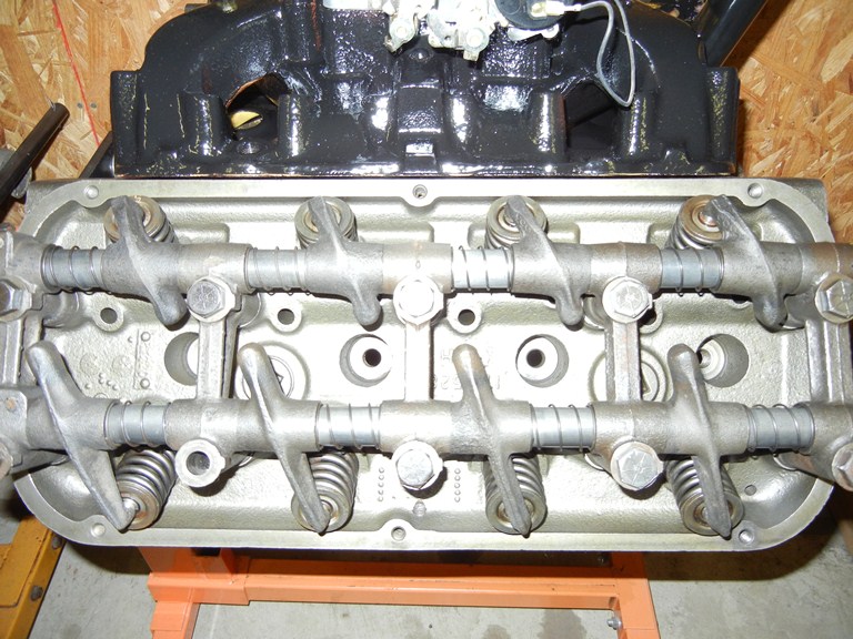

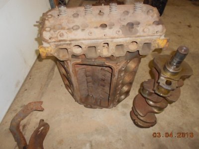

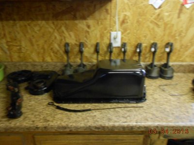

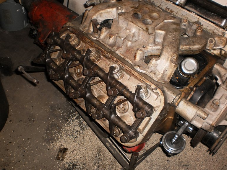

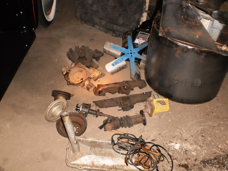

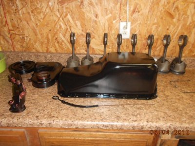

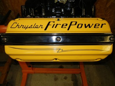

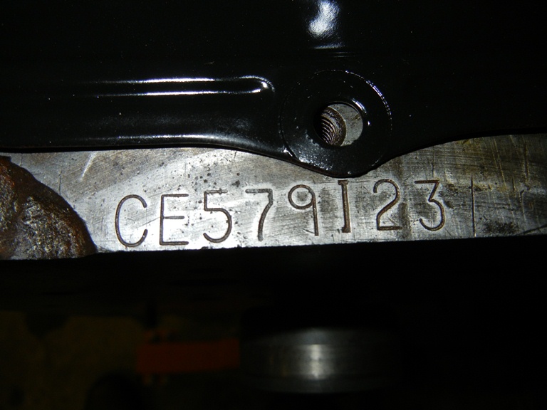

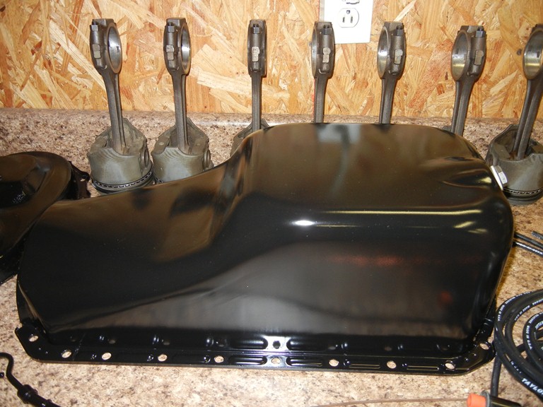

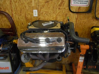

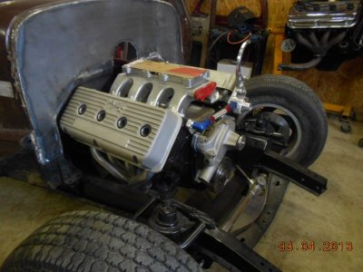

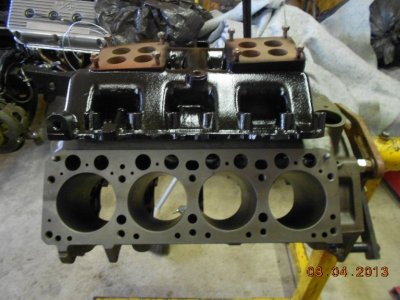

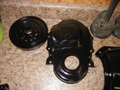

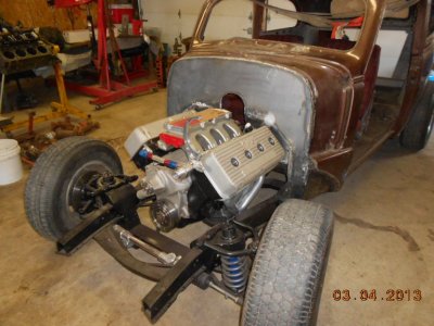

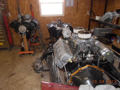

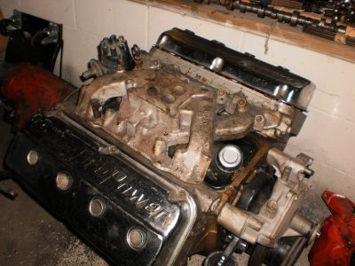

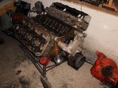

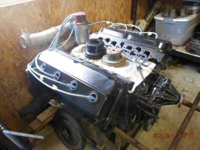

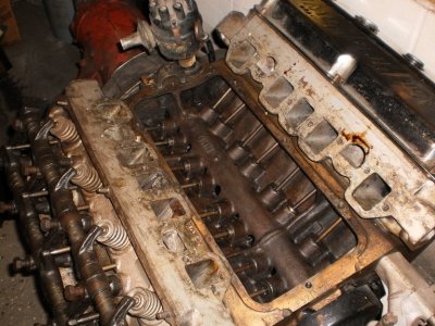

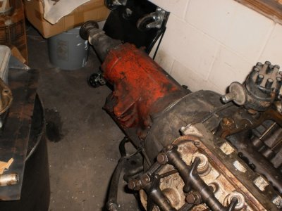

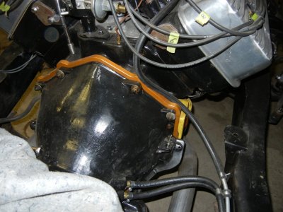

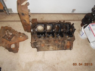

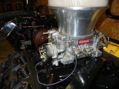

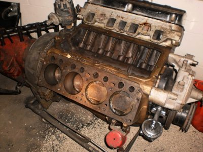

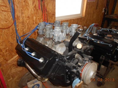

I got luck and found a guy who builds lots of early Hemi's but he just does it for fun in his spare time
so he is building me a 392 , exactly the way i want it all set up to bolt right in and right at my budget
the yellow valve cover is the one he is building for me , getting a modern 340 high volumn oil pump and mild lobe isky cam
a 350 tranny adapter and modern electronic ignition distributor .

Cool. Glad you located one. I just rebuild my oil pump. The 331 is different. The modded 340 pump will fit, but it only puts out like 3% more than the stock Hemi pump, so I just rebuilt mine. What's the guys name that's doin it? I bet he's a member over on The Hamb.

I got luck and found a guy who builds lots of early Hemi's but he just does it for fun in his spare time. so he is building me a 392 , exactly the way i want it all set up to bolt right in and right at my budget
that guy has got some cool early hemi's... a 392 Hemi will be cool as hell in that Nash/Rambler....

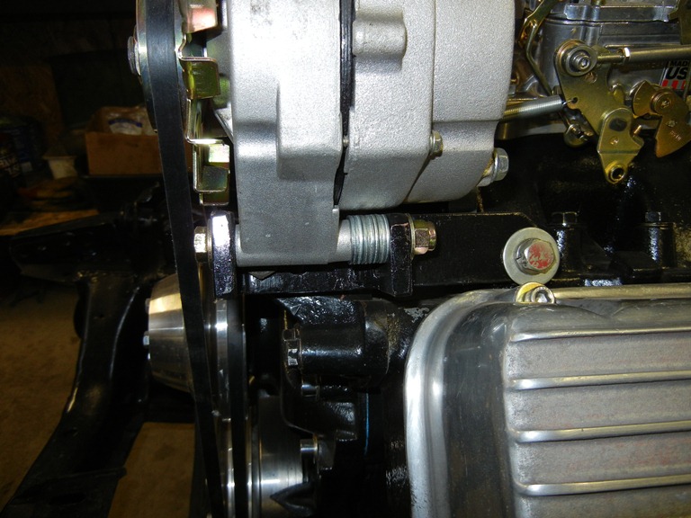

mine will be pretty stock 30 over to clean up the bore and a slightly bigger cam and high volumn oil pump. Setting it up to run the current one wire GM alternator and the GM HEI electronic distributor just to keep it an easy switch over and in by budget. I'm sure In the future I will up grade to some kind of cool looking multi carb intake of injection system but for now just a single 4 barrel edelbrock .

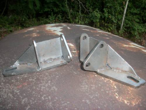

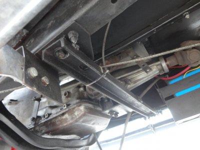

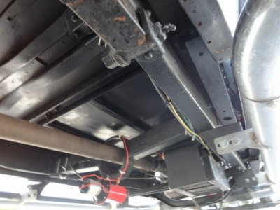

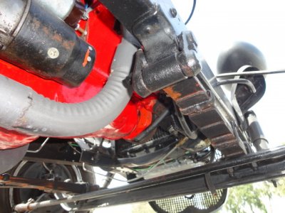

Whats the chassis like on the nash Stu?Hopefully the rails are boxed atleast in the engine area.That engine has to be like 300 lbs more than a sbc?
yes its boxed in some sections but may need more up by the motor

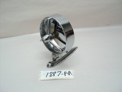

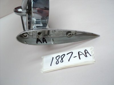

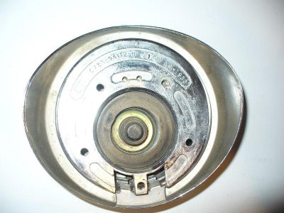

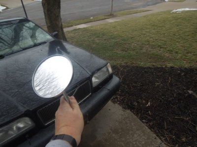

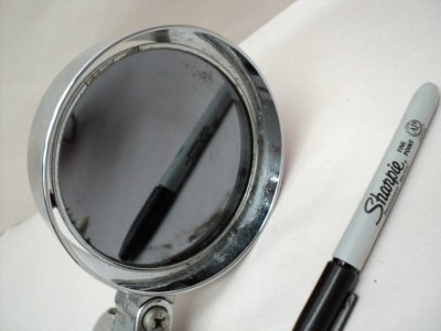

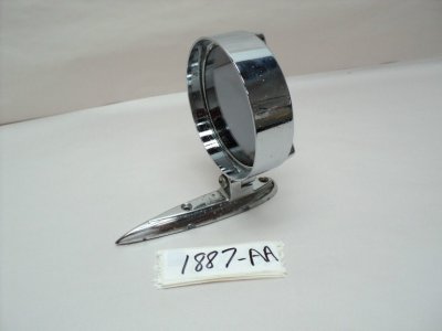

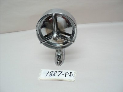

Still needing to make a passenger side door mirror < i found a cool mirror on ebay to mate with my ford GT flip top gas cap to make a passenger mirror
