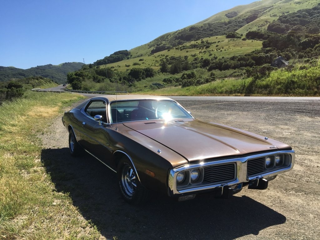

After saying goodbye to my protouring daily driver dreams I had for my 70 Dart, I have recently turned my attention to the fanily heirloom now in my possession. My uncle decided it was time to hand over the keys to his, now my, 73 Charger.
The car is essentially all original, it was his daily from 74 till about 95, then garages without movement till the late 2000s. Now that I own it, I try to drive it as often as I can. The more I drive it, the more I want it to be my every day ride!
What I now have in mind is an evolved form of my Dart plans. I want to basically create an incognito Pro Tourer of sorts. I want to keep the old school look with 15" cragars and fat tires and the late 70s rake, but I also want the car to handle and brake and get good gas mileage (good being a relative term with a 400ci big block!).
I already know I'd like to throw a GearVendor into the factory 727, perhaps with a shift kit as well. Maybe add 3.55 gears to the rear end when I add a SureGrip. I know I want to keep the original engine, but I have no idea what I should do about getting more ummph out of it while improving the mileage as well.
Is aftermarket EFI worth the investment? Should I consider aluminum heads and a cam shaft? These all seem like obvious considerations but money is of course not in a potted plant in my backyard either
What say you fellow Moparians? This old girl is certainly ready for a bit of modernization. Maybe she won't look the part, but she'll certainly need to perform!
