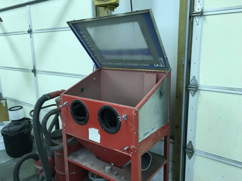

The best mod I’ve done to mine so far was close in the side door and fabbed a top door so the whole top opens. Got tired of trying to get in there to put the film on the glass and the dang sand would pour out every time I opened the door.
Also put good light on it.

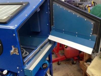

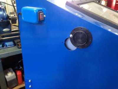

Here's a closer picture of my valve Wayne. From what I can tell I seems to work great. At least no complaints.

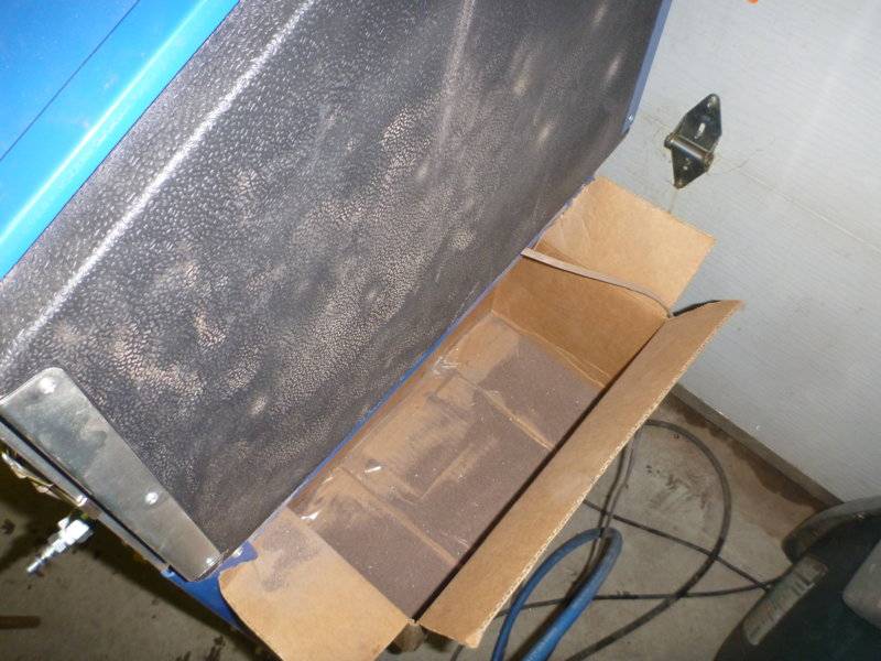

Edit.. you can make out the baffle the young fella made up for me to let air in and keep the media from blowing out. Works great! All ideas found on the web. One of the only ideas I had was the little catch box under the door. Never seen that yet out there. Might be out there but never seen it. But heard lots of guys complaining about media still falling out when door is open. So easy to help catch falling media. Keeping mess down.
Also put good light on it.View attachment 928595View attachment 928596

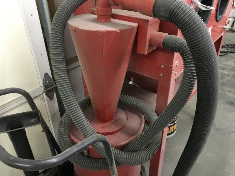

With all these great Ideas I may pull mine out of the corner and get it going. Id like to see inside the dust cyclone.
Doug
I have no intention of opening mine until absolutely necessary. The dust is so fine that the slightest motion has it going everywhere. Hell, I was covered in the crap when I dropped the bucket off the central vac.

I built my own cyclone too I’ll post a pic I rolled the cone from sheetmetal

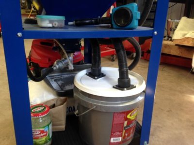

I'm telling you fellas I made mine(Dust Cyclone) out of a five gallon bucket with just a couple of elbow mounted in the bucket one pointed down for the exhaust out of the cabinet and the intake to the vacuum is a couple of elbows that turns the intake up to the top of the bucket right under the cover. Easy and cheap. Not to mention it works. Used it for the table top version. I just use a filter and a bag in the vacuum. None in there to speak of. Now since I have the floor model with wheels. Forgot to mention that. lol I used a empty Evapo-Rust bucket so it can fit under the shelf for easy storage and a uncluttered look. And can roll the whole unit over to the compressor with no effort.
I like mine better Wayne. I had one just like that though.lol

The good thing about that homemade valve Wayne is I only use about a cup or two at a time. You can see in some of those pictures that I have a couple of pickle jars. I put the different media in them when done. Not even half full. Then I reuse it if it's not spent. I tried different types of media to see what nozzle works best, how much pressure works best and what media works best. But today is the first time I really used it on some crucial parts.
That's all Stan. Maybe two cups but it works on one. Serious. I have no reason to BS. I know hard to believe but that valve does really work. And those little pieces that I had my son bend up make all the media fall back down the funnel works great. I'm telling you. I seen all those how to vids and scoured the net for what I thought was the best modifications for this thing. Plus I have no life which helps. lol I don't want to say how many hours I have on it between research and assembly. Really no life lol!
