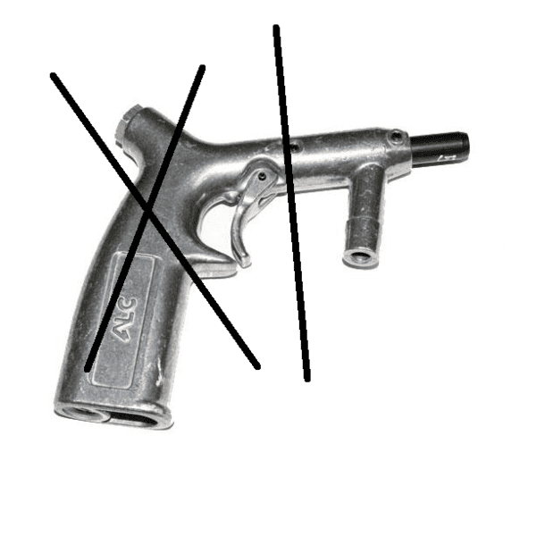

Looking really good Stan! More industrial than mine. So where did you get the gun housing?? Like I said I'm going to get a 45 degree elbow if and make it work if this gun doesn't pan out.

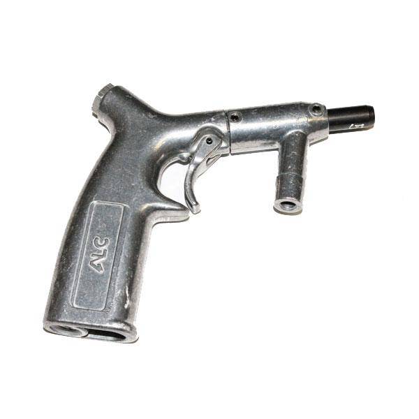

The gun ... these are real cheapie siphon blaster guns - usually like $19.99 or so. Sold in many auto parts shops, flea markets, etc, etc. Maybe CT or Princess but I didn't see one on Princess website.
Anyhow, I just use the front end and chuck the rest and make a copper elbow to replace the handle (air feed).
