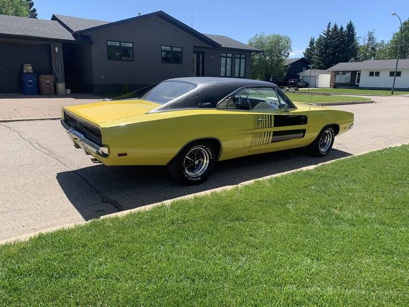

It has a parking sticker on the windshield from the a high school where my first girl friend went to school in 69. I think of that time every time I see that sticker. Stupid HUH?
Very nice.Thanks. I think all second gen chargers are beautiful. Yours included of course. Mine is a 69

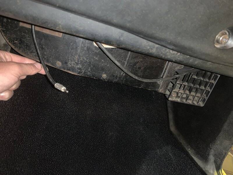

Yes, as others have said, that's the male end of the antenna cable. I completely refurbished my factory original sound system in my 69 Charger, so I've got a bit of knowledge on this topic. if you're so inclined, I'd encourage you to reinstall the original radio system. It's surprisingly easy. I'd start by looking at the fender tag to confirm what your original radio was. Probably a simple AM radio, which meant that you'd have an in-dash speaker and an antenna to round out the system. If you still have the original radio, be sure that you've installed the support bracket on the back of the radio that attaches to the lower part of the dash. Then make sure you have the right antenna with the cable clips that clip the antenna cable to the underside of the dash as well. The male end in your photo plugs into the female receptacle on the driver's side of the radio box. Make sure you have a complete and correct wiring harness to the speaker, and the correct 12V power connection to the dash main wiring harness. If you fire it up and it doesn't work, you may need to send the radio out to be repaired. There are several good places nationwide that'll do this for you. If your speaker is shot, don't buy a new one. Have Heavy Sound in Venice CA rebuild your original. I promise you'll enjoy the result. I love to original AM/8-Track with three speaker dash and the rear speaker in my Charger. Best of luck! CRUISERFellas, what the hell is this wire/cable hanging under my dash, passenger side? It comes out from the kick panel and has been hanging there ever since I bought the car.
I appreciate the detailed and concise reply. Yes, it's just an R11 2 watt radio. I don't necessarily need the radio working, I just wanted to do something with that cable hanging under the dash. Regardless, I'll see what I can do to get it operational.Yes, as others have said, that's the male end of the antenna cable. I completely refurbished my factory original sound system in my 69 Charger, so I've got a bit of knowledge on this topic. if you're so inclined, I'd encourage you to reinstall the original radio system. It's surprisingly easy. I'd start by looking at the fender tag to confirm what your original radio was. Probably a simple AM radio, which meant that you'd have an in-dash speaker and an antenna to round out the system. If you still have the original radio, be sure that you've installed the support bracket on the back of the radio that attaches to the lower part of the dash. Then make sure you have the right antenna with the cable clips that clip the antenna cable to the underside of the dash as well. The male end in your photo plugs into the female receptacle on the driver's side of the radio box. Make sure you have a complete and correct wiring harness to the speaker, and the correct 12V power connection to the dash main wiring harness. If you fire it up and it doesn't work, you may need to send the radio out to be repaired. There are several good places nationwide that'll do this for you. If your speaker is shot, don't buy a new one. Have Heavy Sound in Venice CA rebuild your original. I promise you'll enjoy the result. I love to original AM/8-Track with three speaker dash and the rear speaker in my Charger. Best of luck! CRUISER
