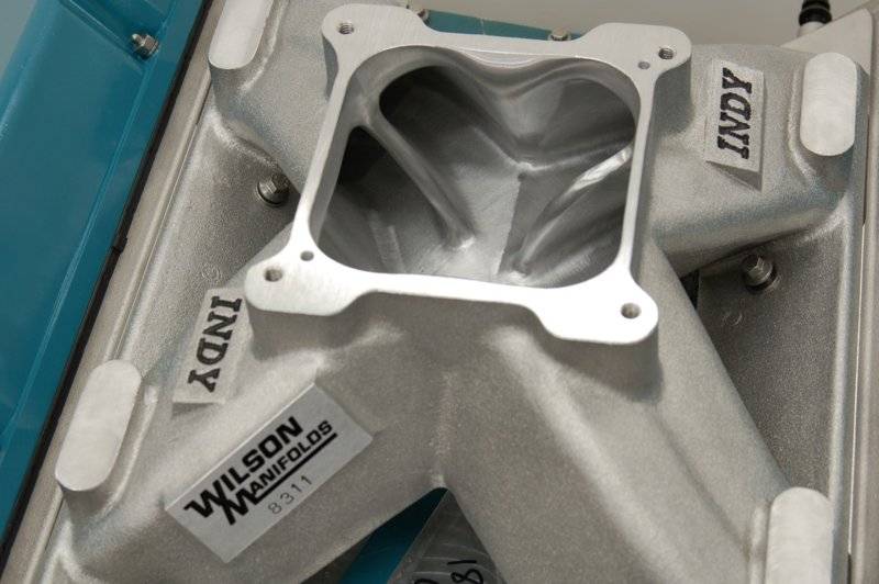

You’re out of luck on the low deck dual plane. Good news is a 500in motor doesn’t need one. Indy single plane will be the best bet.

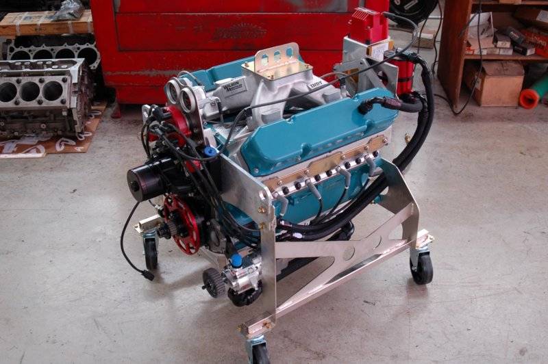

There aren't a lot of low deck intakes. Not many choices for low deck main bearings either. The aftermarket hasn't really supported the low deck very much over the years, especially not a low deck max wedge setup. That combo makes sense on paper but it isn't something that the aftermarket really "gets". I did a low deck with 270 heads last year for Car Craft. It made great power but there was only one intake that fit and it was junk out of the box. After $1000 of port work it made excellent power.

You can pick up some power by moving up to the 270 heads but it gets expensive. You need a good engine since you'll be spinning it higher and harder and you'll need a good intake to take advantage of the bigger ports. Nobody makes a good intake so you'll have to start with an Indy and work with it until it is good. Personally I wouldn't recommend putting MW heads on a low deck unless you're really committed to the task. And if you want to make so much power why are you starting with a stock block? At some point it just doesn't make sense.

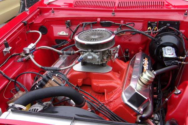

Its a bummer for low decks as they don't have a great intake manifold selection. Its to bad as I run this Indy dual plane on my 440/493 and it has nice size ports and can be opened up to Max Wedge size. Its a nice street intake which my car is 99% street driven and I really like this intake on the street. Indy should make one for the low deck engines. Ron
I just finished a stroker 400 (498") using the tf270 max wedge heads. I ordered the intake thinking (silly me) that when TF people said it would work, they meant it was MW ports. Wrong. So had it welded, then matched the ports. I ended up polishing the outside. It turned out pretty nice, but had about 12 hours (rough gues) in it. Hated the look of the Indy, besides other conerns.
