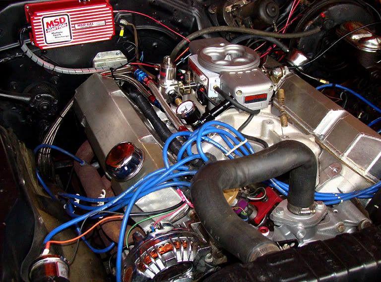

Ok, Right now I have a 74 RoadRunner, it is a 4 speed car, and has an 8-3/4 rear with 3.91s..
Current combo is a 383, crappy pistons way down in the hole (they are old TRWs I believe that were new in the early 90s) it is fuel injected, Edelbrock RPM intake, XE268 cam, MSD6AL, 440 Source Stealth Heads, and of course headers and dual exhaust..
The old combo was the same other than steel close chamber heads, and a Mopar 509 cam.. and it ran OK once the RPMs came up, but it was a dog down low.. The new combo is not much better, I think because I killed my compression with the new heads..
SO... I am now looking at a set of KB400 pistons to bring compression up, keeping the Edelbrock RPM intake, and out of the box 440 Source Stealth Heads. What would you suggest for a cam? This is a street car only so I am more concerned about torque than high RPM HP.
