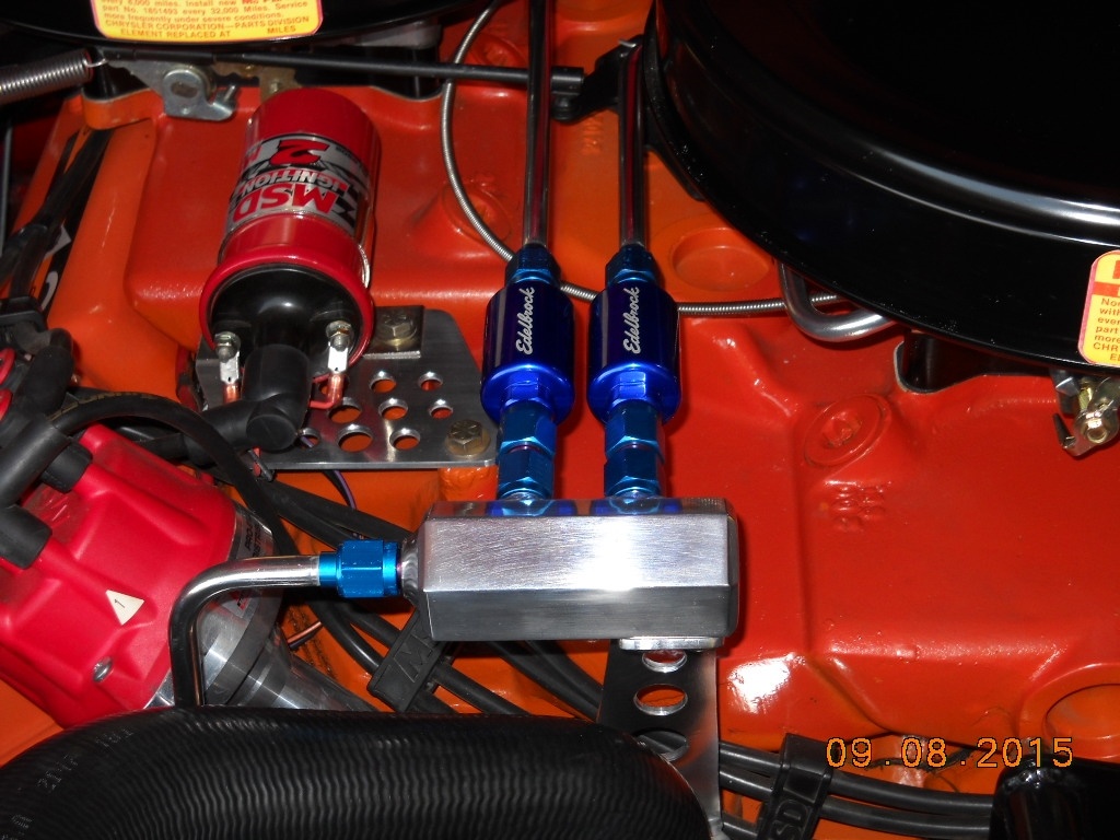

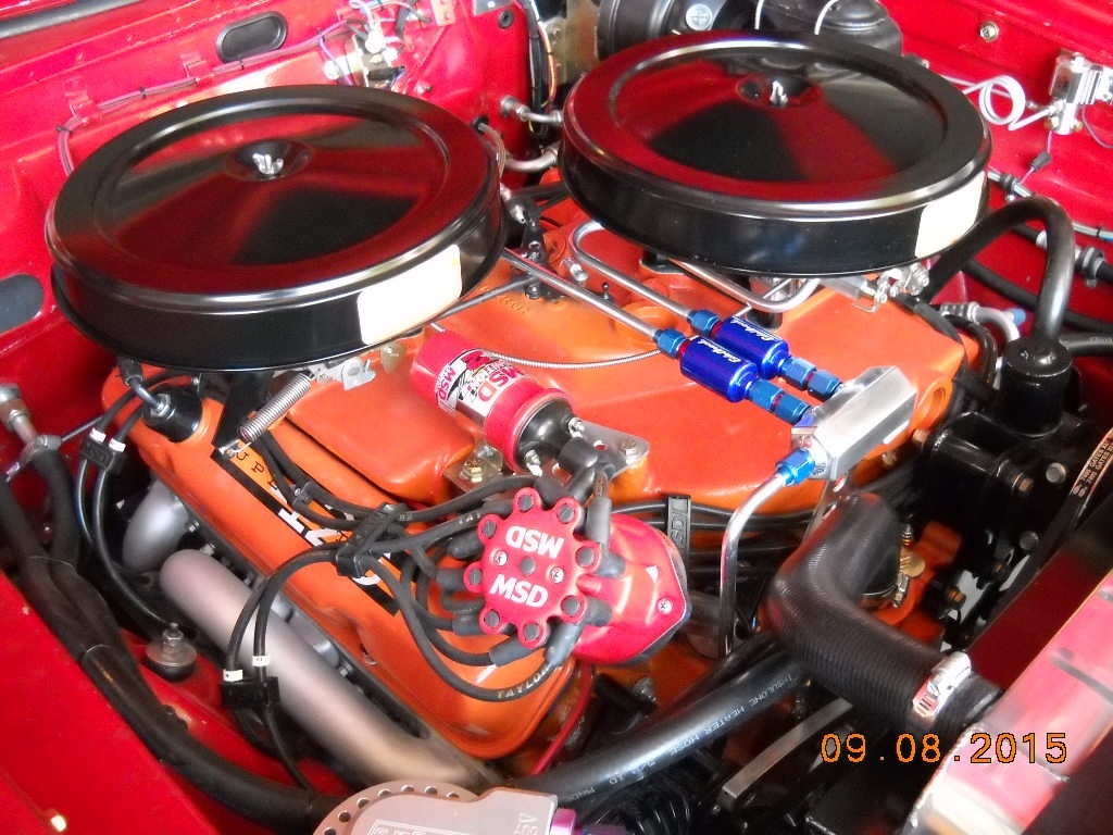

Sure, why not? Fab it up with inexpensive Home Depot materials to try it out. If you're happy with the results re-do it to make it pretty... Fuel, not air. but you can get the idea...

Beautiful power plant!! I think I will take your advise and make a trip to Home Depot and try something out before I go to the expense of changing so much around. Thanks for the thought.

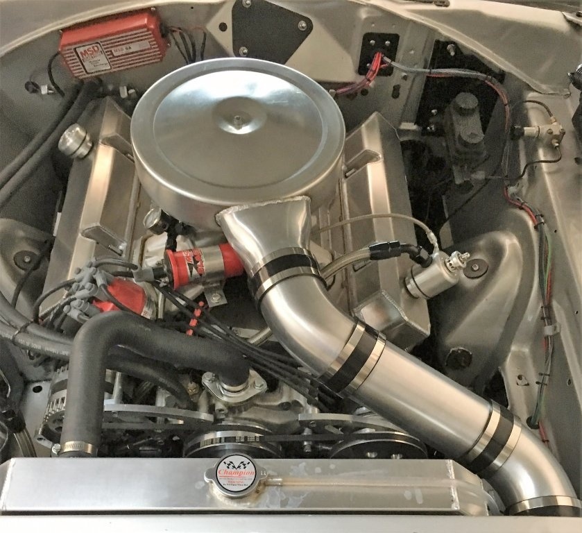

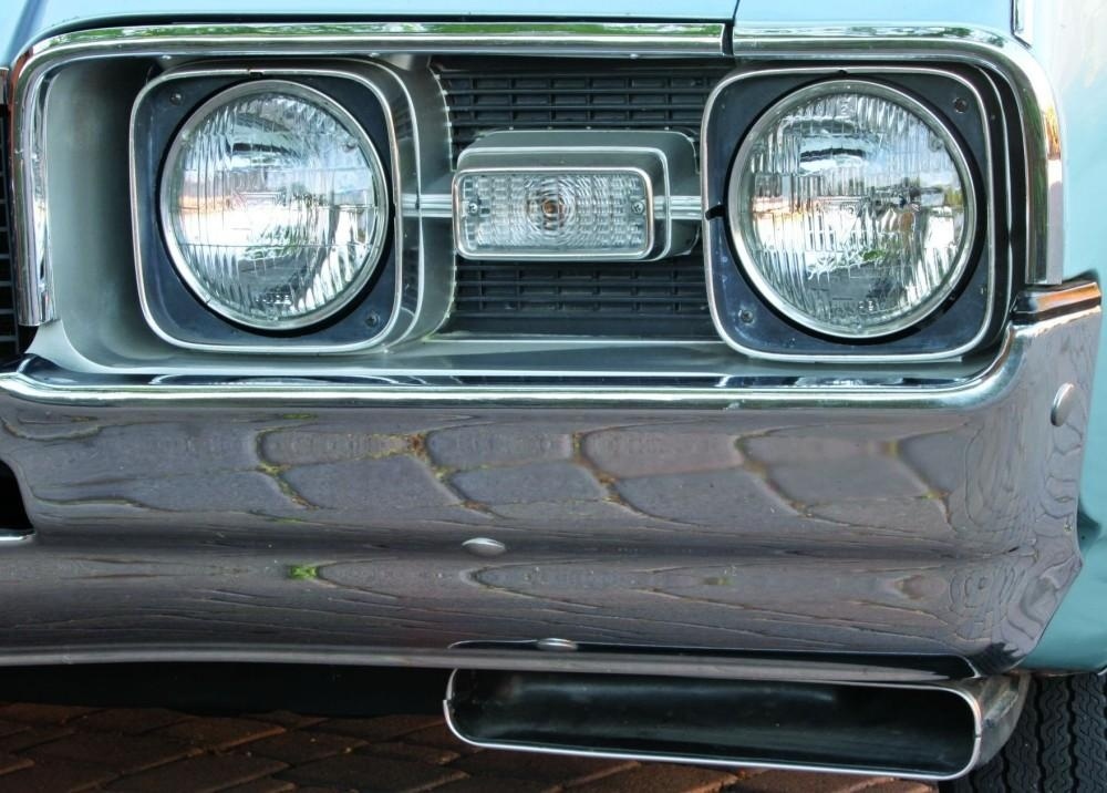

Now that is creative. Lionized, any idea who did this and what it was formed out of? I went ahead and moved the Battery to the trunk to open up the driver side of the compartment. I moved the electronic ignition box back toward the middle of the bulkhead on the passenger side. I meticulously measured for the 4" pipe to run to the area where the horns are. I did not take into account the diameter of the friggin cone filters and now I have interference with the ignition box, when mounted as planned. So today I will have to relocate the box again, if I can find a proper place. The concern I have is the effects of heat from the headers as move the box closer to them. I may have to move the wash bottle over to the driver side and put the box where it is. I'll post photos when it is done.
Factory Olds in 1968-69. Not sure if you're going to have room for the dryer duct but it'd be awesome if you did!
