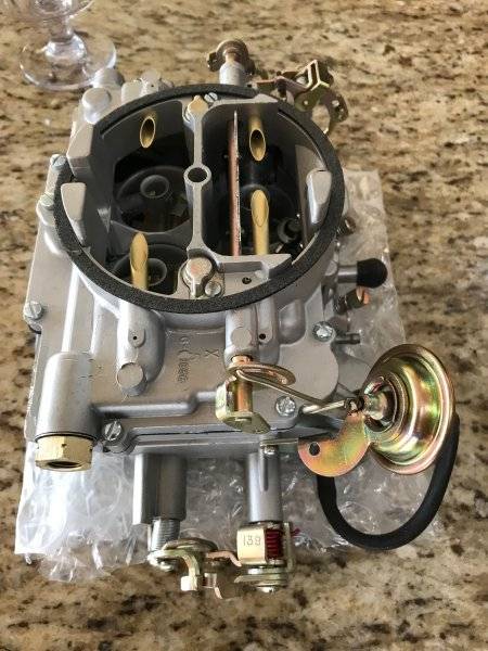

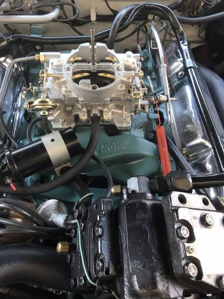

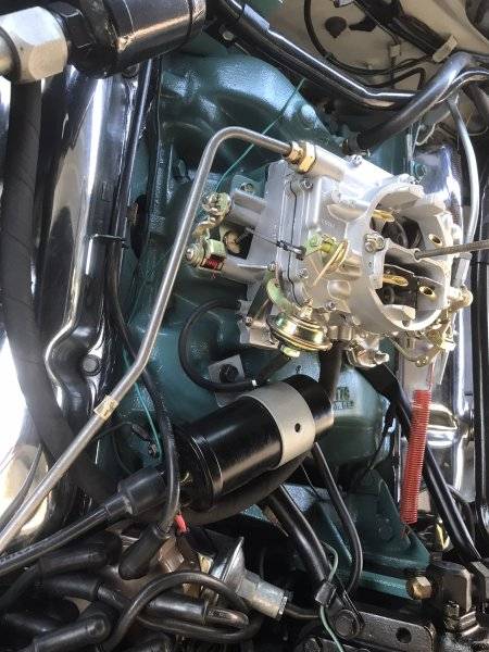

I was running manifold vacuum advance off of an 800 Edelbrock AFB-type carb on my 67 GTX. But, I had a correct 67 Carter AFB 4327 restored and I installed it last spring and again hooked it up to manifold advance. I do this by “T” into the choke pull off vacuum hose which comes off a low port on the right side.
