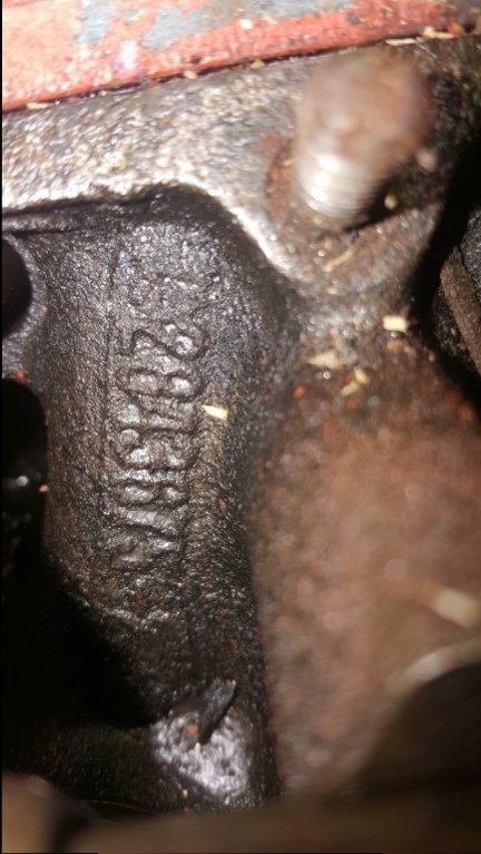

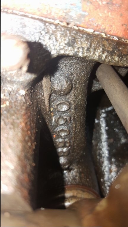

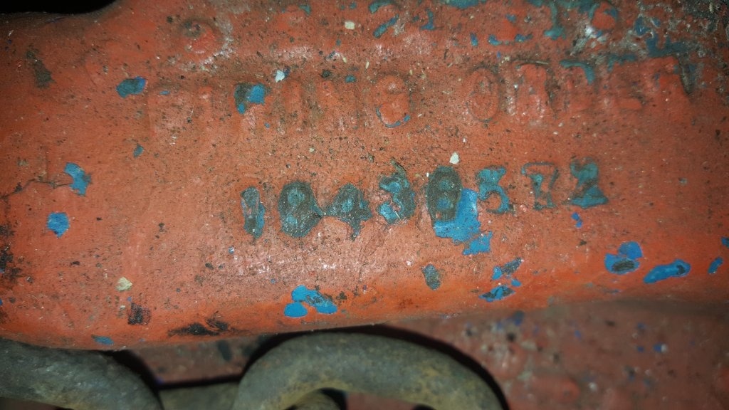

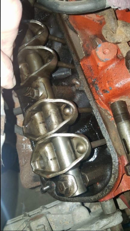

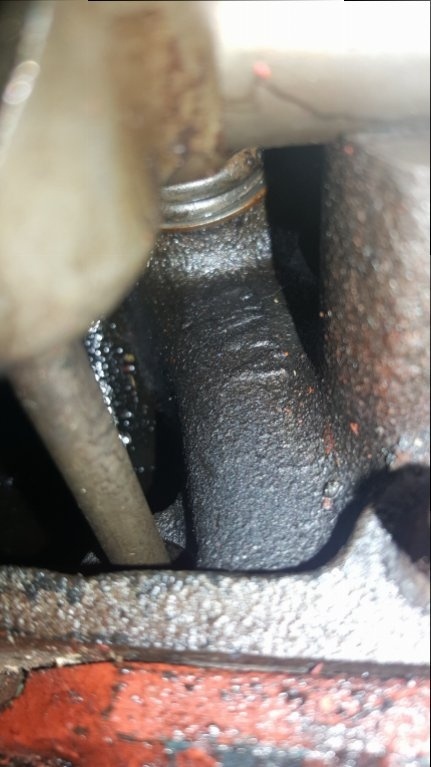

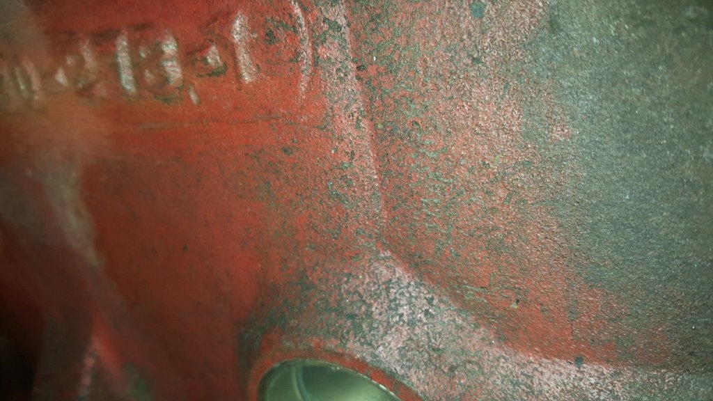

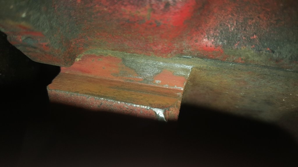

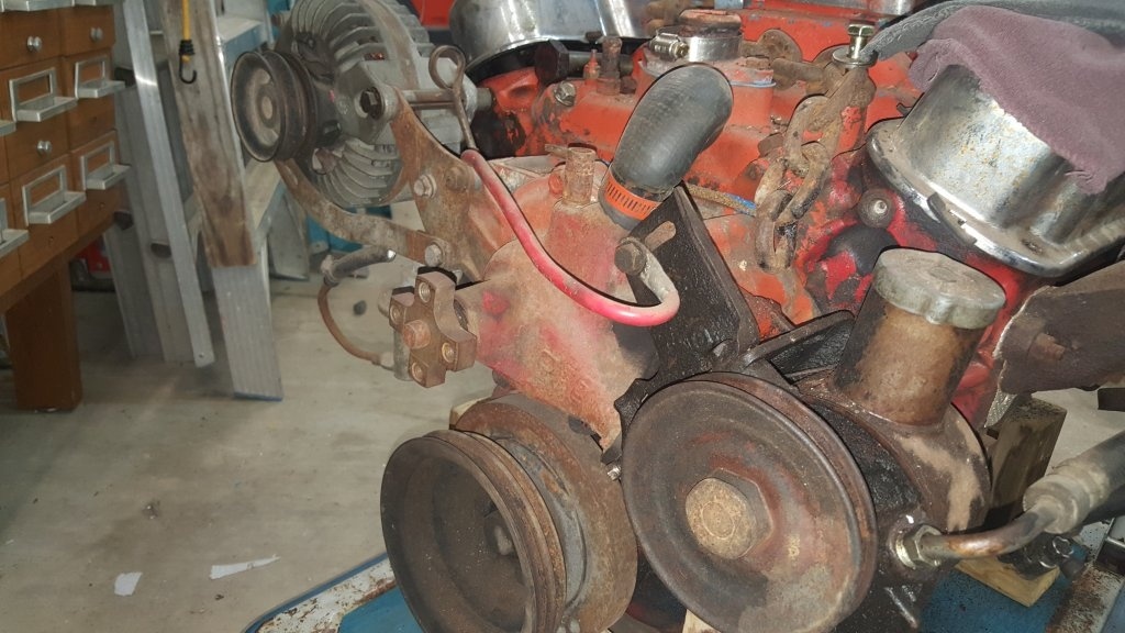

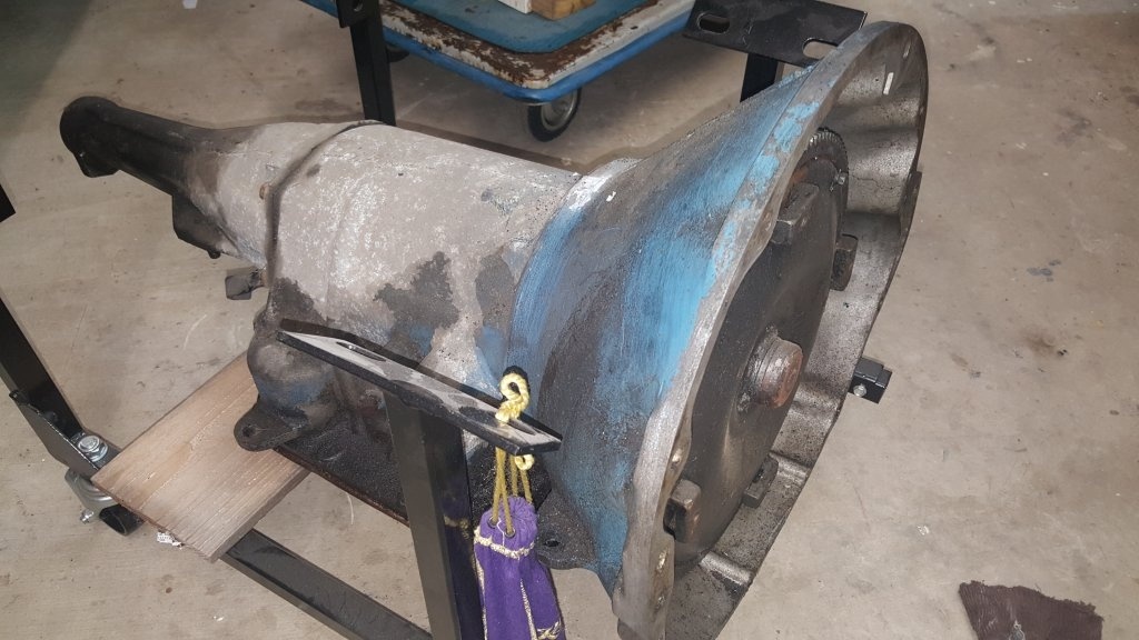

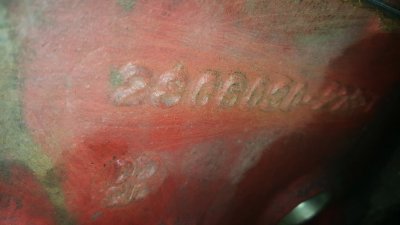

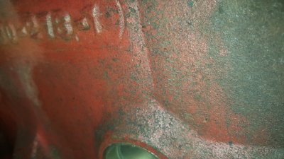

hi all, pretty new to mopars, picked up a project, this engine and trans came with it, seller said it was a 273, but casting number says 318, nothing stamped on pad where vin should be,replacement engine maybe?also trans and rear end?...still learning here, different animal than what I am used to
20160429_200738.jpg 20160429_200806.jpg 20160429_200831.jpg 20160429_200858.jpg 20160429_201205 - Copy.jpg 20160429_202023 - Copy.jpg 20160429_202125 - Copy.jpg 20160429_202125.jpg 20160429_202157 - Copy.jpg 20160429_202157.jpg
Those are 273/318 heads used from 68-74.
Here are the block casting numbers you should look for.
2465330 273 1964-66 LA
2806030 273 1966-69 LA
2463252 273 - LA
2536130 273 1965-69 LA
2806130 273 1966-69 LA
2264230 318 1960-66 A Polysphere
2468230 318 - A Polysphere
2532630 318 - A Polysphere
2466090 318 1967-74 LA
2806030 318 1966-69 LA
2806030 318 1967-74 LA
2536030 318 1967-75 LA
2566080 318 - LA
4104230 318 - LA Race - Painted Orange

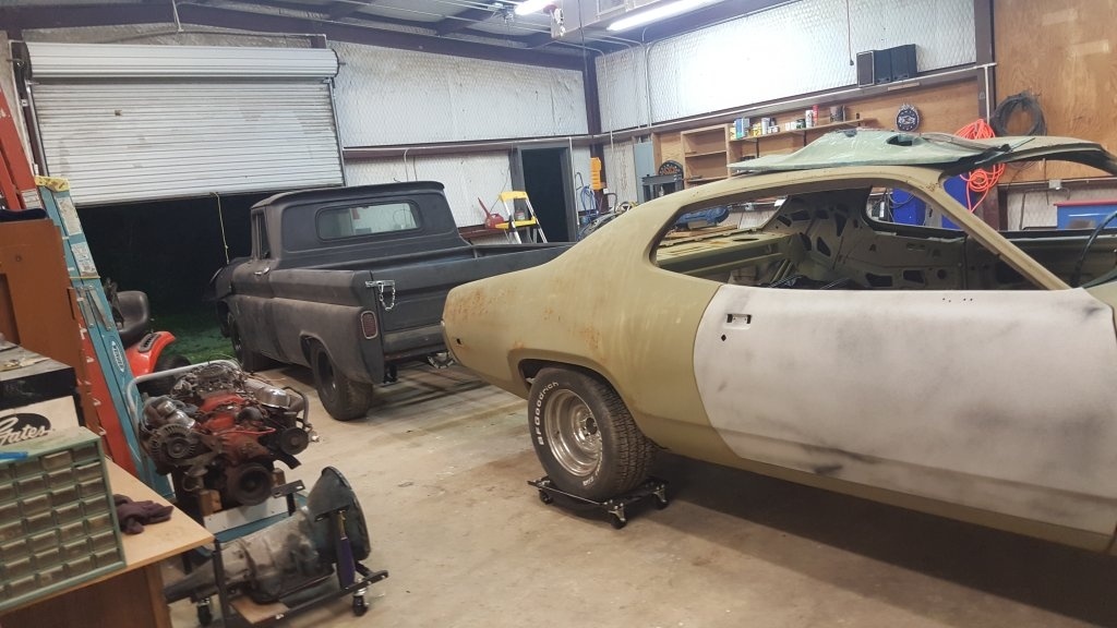

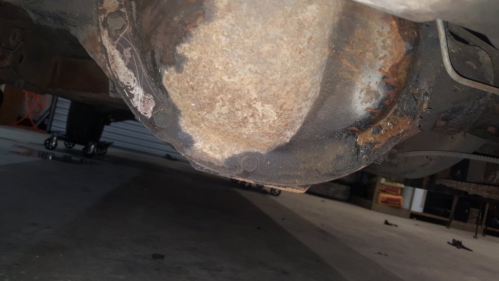

thanks for all the info...looks like 2806030 273.. I assume it is a 273, building this car for my wife, don't know much about these engines?. is it worth building for a mild/little more than mild street car?,she also wants a 4 speed..looks like a 7.25 rear end, guessing that probably has to go.
20160429_200601.jpg 20160429_200619.jpg 20160429_200631.jpg 20160429_200657.jpg

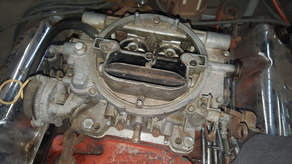

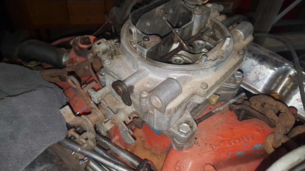

Looks like carter carb. You can build up that motor a bit, some here may disagree and say put in a 340 or 360, but you can get more performance out of it. Regarding the rear end, it depends how much you are going to abuse it, and with a manual trans and higher horse power, might not be a bad idea to go with something bigger.
What car do you have with all this?

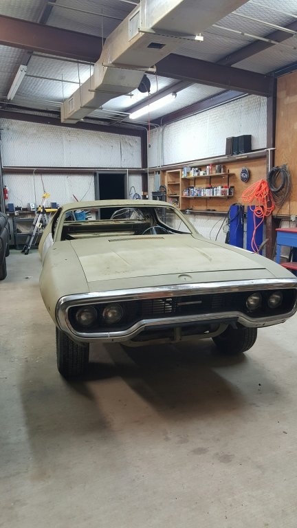

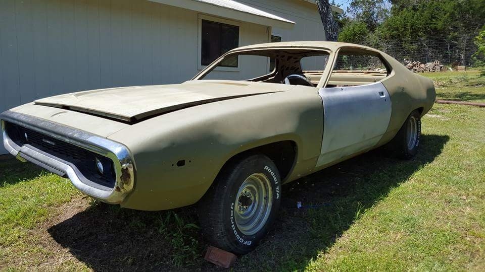

72 Satellite 2 door, she wants a roadrunner clone, sorta... LOL
20160426_221918.jpg FB_IMG_1461453324334 (2).jpg FB_IMG_1461639639348 (2).jpg
That looks like a fun project! If I had something like that I would go big block and 8-3/4 rear end, but big block requires some changes to the k-frame and/or engine mounts. Also, if this is an auto car and converting to manual, there may be some changes to the trans tunnel for the manual trans conversion.
