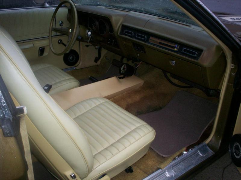

100_0873.jpg100_0875.jpg100_0861.jpgdoes this look like water damage to you?
Possibly looking at this car..looks like a survivor..
guy said he bought it at an estate sale but the carpets look to be water damaged and the dash is cracked to sh*&*^&t

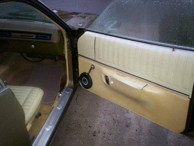

The carpet looks like it has some serious moisture damage, hard to tell with the floor mat in the way. The cracked dash pad is typical. 71-74 dash pads are next to impossible to find without cracks. The lower passenger door panel has some weird discoloration spots. It almost looks like someone tried bleach-white or some other chemical to clean it and had bad results.
Good looking car, but I would for sure look under that carpet.
Idk about which years it affected, but it could be from a wiper pivot leak. Are asking if its a flood vehicle? or just moisture damage? If your worried about flood damage, look at the sub frames.

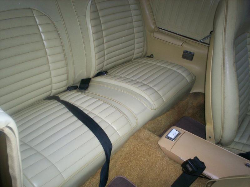

100_0865.jpg100_0864.jpg100_0874.jpgThe back seat carpet on the drivers side has the same discoloration.. I was thiking it was a flooded in which case its not a good idea to buy is my thought.. the door panels maye have been moldy and they tried to clean it or thats was if left after the mold is cleaned off

look at the interior after the windows have been closed for awhile. Does the interior smell? Do you smell mildow? I agree i would also want to pull a small area of the rug up and look at the underlayment and floor
I am not too sure without seeing it in person or some detailed pictures. One thing that I always see in flood damaged vehicles is a large amount of silt in the frame rails. Something to check...
