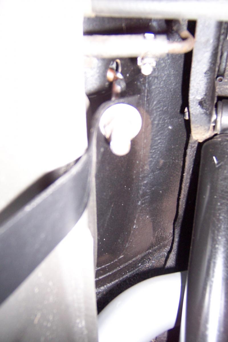

hello. there is about 1/2 to 3/4 inch thread hanging out of the end of the j bolt ( you can see it in the picture ). make sure your straps are sitting in the t-slot near the filler neck. this is on my plymouth 68 gtx. hope you can see the pic. the j bolt is way up in.

Thanks. It seems like the j bolts are so far away from the straps. I sat underneath the car under the tank and pushed my body against the tank to hold it tight to the car. It was record humidity and plenty hot today that I finally gave up again. The straps seem to be the same shape as the original ones, but maybe I will tweak the straps a bit to get it. I could not see the j bolts clearly on the Road Runner picture and am not sure if they mount the in the same place. I will try again this weekend. Thanks again for any advice or pictures.

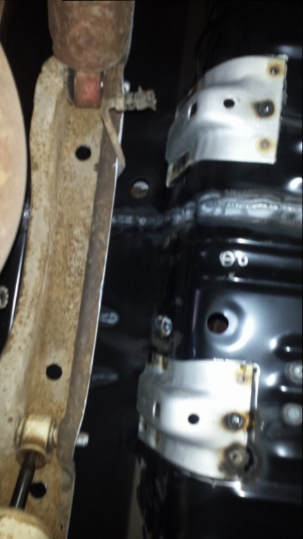

Can someone send me a picture of the gas tank j bolt brackets that are welded to the car. After sitting under the car staring at the brackets I think I now know why I can't get the gas tank in. The idiot that originally did the trunk pan welded the brackets in upside down. I can't find a clear picture to confirm my findings. Any help is appreciated so I can solve the mystery.
Brackets
I know mine are set up where the bolts slide in the top of them and then slide down. So if yours are that way they are either up too high are you have the wrong j bolts. Good Luck Ronnie

We found out the idiot welded them in backwards so now comes the engineering project to get them right side up. Thanks for the help. I will post when it is finally in.
Helpful thread everyone... could someone send me pics of the J Bolt brackets that get welded to the floorpan? Thanks!
