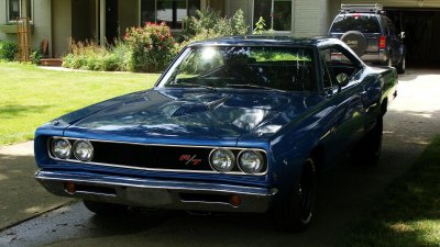

Included photo of car.

Damn- pic made me drool so much got to go change my shirt now....nice ride and good luck!
