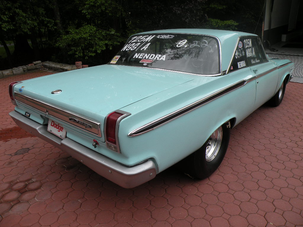

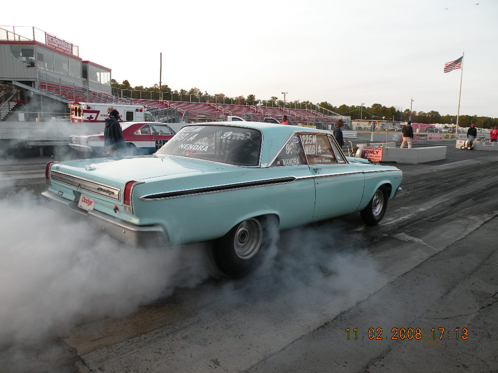

29 x 10.5w hoosier with no minitub and 15 x 10 wheel with 6.5 backspacing.
