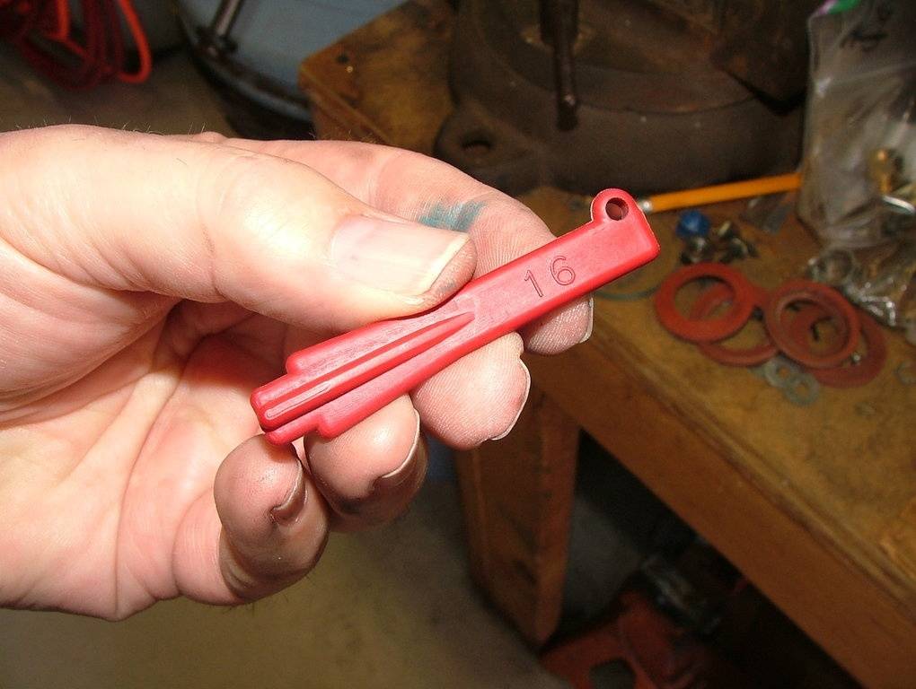

OK here we go. I set the centrifugal advance at 16 degrees to start with and will do the rest with initial, I'm leaving the springs as is for now. Now that I've done it adjusting that distributor is a snap, good design.
So it took a while but I finally finished all the ignition updating and got it buttoned back up. I hooked up my fancy new Innova timing light and checked her out this morning. Without adjusting anything the initial was at 20 degrees and the total was 34 degrees at 2250 rpm. 2 degrees less centrifugal than I set but I decided to leave it alone and do a test drive. Summer is already kicking our butt in Texas, its about 92 with a heat index of 104, so the A/C was on for my whole trip. I stopped and got some gas then drove for about 30-40 minutes mixing regular stop and go with some highway at 60 to 70 mph. So far I'm very pleased! It pulls harder and smoother in all gears and revs more willingly. It does not seem to be straining at higher speeds like it did before. I did not notice any pinging although with my lousy hearing and those damn loud mufflers who knows? - at least nothing obvious. I'm going to recheck total timing at 2500 rpm and maybe fiddle a bit but for now I'm glad this last project has paid off. Thanks to all who responded!
