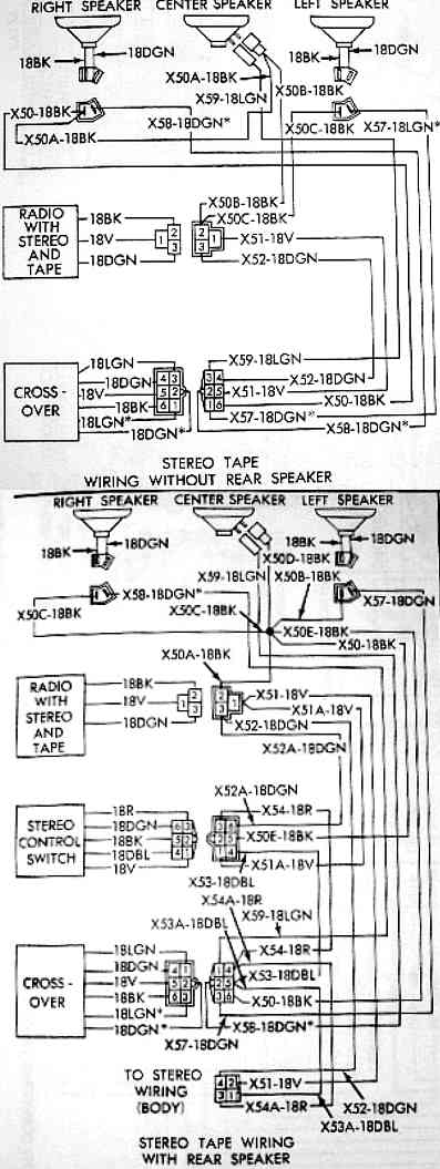

I have a 70 Charger. Finishing up the wiring and I am stumped with the speaker setup. I have a fader and 5 speakers. How can I make this work? Will I just have to make the wires? Where can I get the connectors if I can get a schematic? Any help appreciated.
The fader was NOS in a box PN 2947230. I also have a crossover with a 6 prong output. PN 2864 863? Maybe. Can or should I use the crossover?
My 8 track has been rebuilt by Wards and I really would like to make this work..
The radio has a three prong output, Bk, V, and DGR wires.
The crossover has a 6 prong connector
The Fader has a green wired one prong female connector on the left and a one prong male black connector on the right. There are two 2 prong connectors in the middle.
Thanks Robert
I found a schematic. Any ideas where to get the harness?
