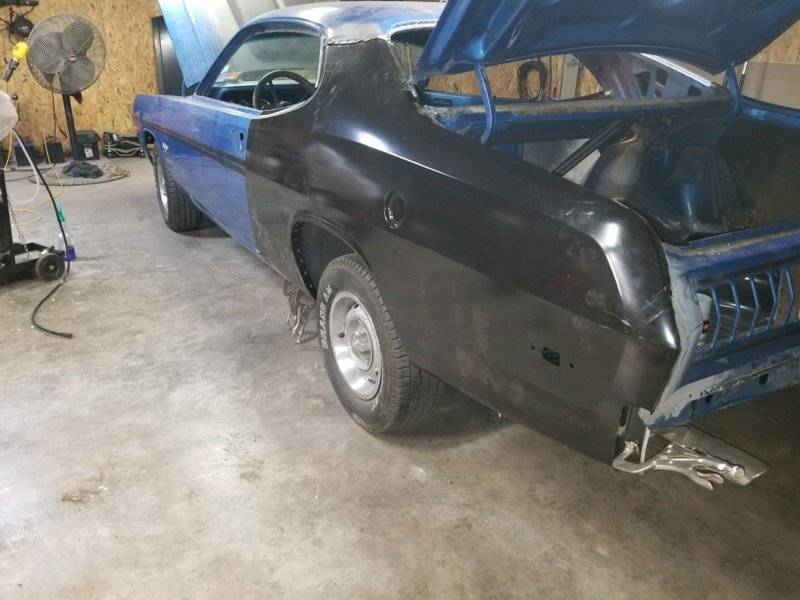

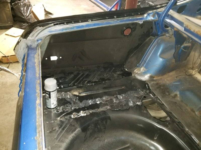

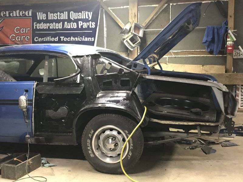

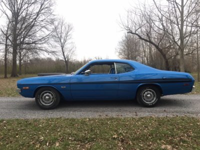

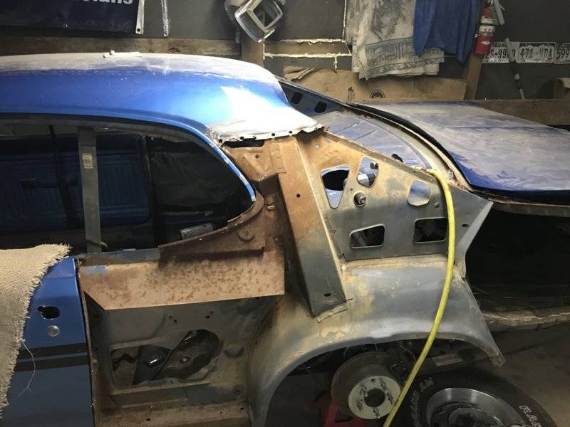

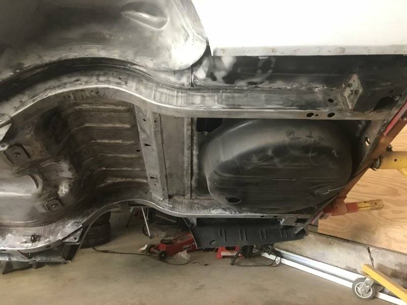

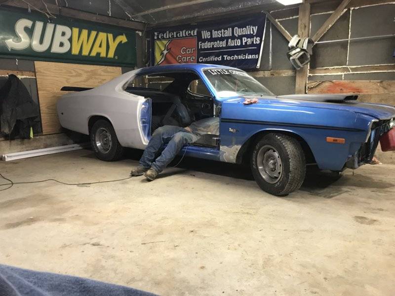

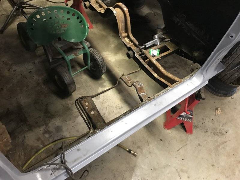

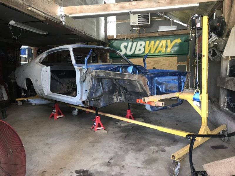

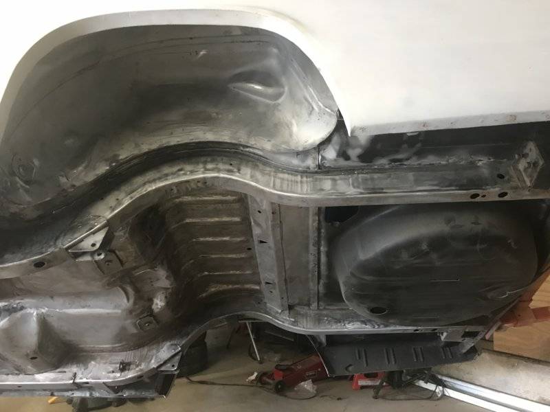

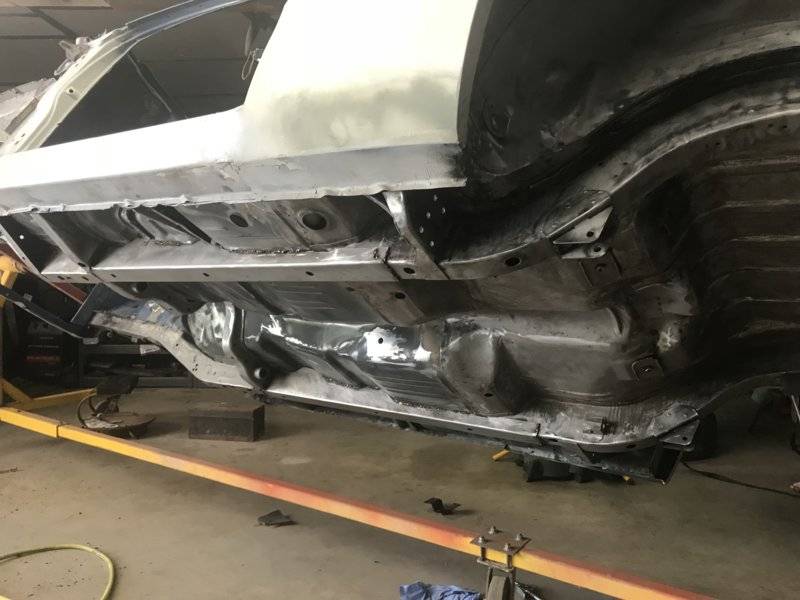

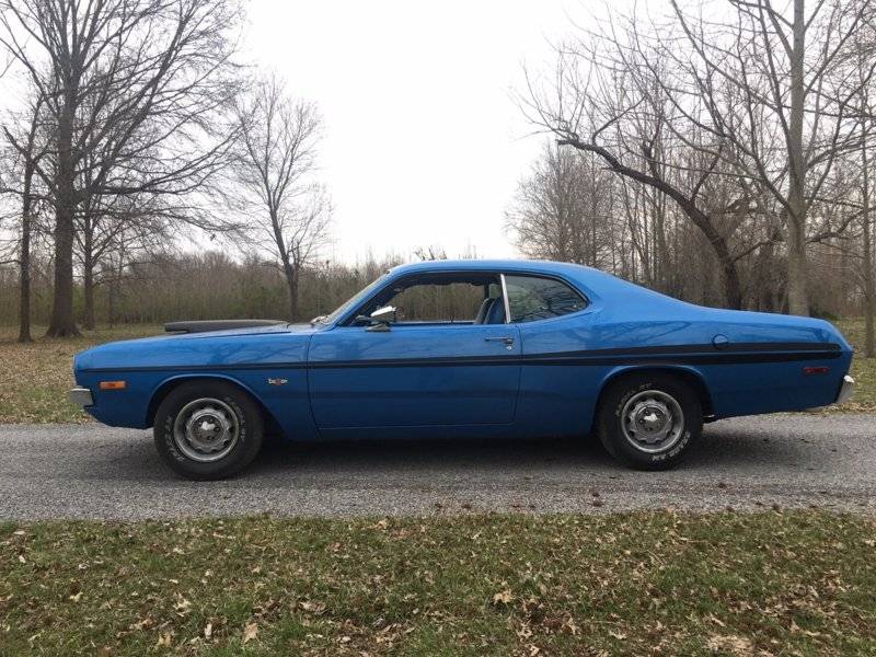

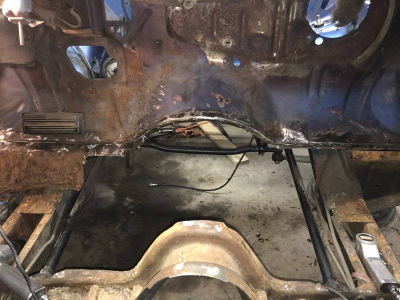

Thanks for your info. If I go single stage on the bottom/ and engine bay/ when I spray the main body will the engine bay match the rest of the car with b coat/c coat. As I said before I think you guys for your knowledge and information I’m just trying to show my son that things can be done if you try so far we have installed quarter panels drop offs trunk pan floor pan. Before this project I have never welded beforethe last pitcher is of the car before we started. KB9GIB

Car looks good. Yes the color should match. The only thing to know is if you buff single stage it does alter the metallic some but usually not so much anyone will notice. Single stage on areas not prone to a lot of UV light is a good way to save money and steps in painting. I've done a few cars in that step and most people I know even some painters don't notice .
