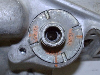

The speedo is on the driver side around the transmission crossmember and the cable screws on to the adapter.
http://www.mymopar.com/index.php?pid=112
This is a picture of the adapter and you will index the adapter with the dimple at 6 o'clock with the amount of teeth on your gear that is installed.As you can see in the picture the slash mark at 26-31 is your teeth and you would index that mark at 6 o'clock if you would have 26-31 teeth on your gear. See pic

The adapter plugs in and has an 0-ring to seal it. Pulls out, pushes in. A clamp keeps it in place. Make sure the clamp is mated with the big slots and the small slot is your mark for alignment at 6 o'clock. If you try to rotate the adapter, you will most likely mess up the plastic gear. Also, the gear pulls right out too. When you reinsert the new gear, make sure it engages with the cable end. It's is a square drive end.

1. This site gives you the formula to figure your tire height and yes it is the overall[diameter] height top to bottom.If you are not sure let me know the tire size and I can figure what gear you need.
2. The adapter just pushes straight in on the index mark that corresponds with the window of teeth of the gear you are installing[ NO TURNING THE ADAPTER] it will ruin your gear by turning it. There are 3 positions that adapter can be installed 45-39 teeth, 38-32 teeth, and 31-26 teeth, so the number of the teeth on your gear will be set in the position on the adapter that corresponds.Align the smaller slash mark below the numbers example 26-31 to the dot on the housing, very simple and just push in.
The adapter is an eccentric because the the gears are all different sizes.After you have it installed the holddown sits in the grooves to hold it in just like it appeared when you took it apart.

I pulled the adapter and didn't realize that transmission fluid was going to come out, oh well.
Anyway, the speedometer gear came out easily when I pulled the adapter. The gear has 40
teeth (orange) and looks like I’ll need to get one that has 32. I reviewed the chart
and cross referencing the tire size and the differential, came up with Speedometer
gear, 32 teeth black. If you have one make me an offer……..
