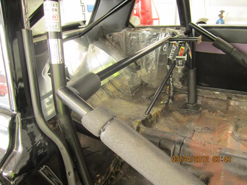

Who offers a carpet with a longer rear section to cover the floor where the seat used to be??

"I don't know for a fact" but I don't think any of the regular guys, have a molded style pre-maid type of carpeting with a longer rear section added, it sounds like a custom interior or carpet shop deal to me... Buy a piece of what color you want, bigger than you need & then use heat & steam, to fit the shape of the many contours, then trim & cut it to fit... Just spit-balling here
I was thinkin' maybe the manufacturer could leave extra carpet toward the rear and not cut it at the seat line:thinker:
If not,they offer yardage to do yer own,that would make it a 3 piece:angry1:

Yup, heat n steam, a POTA but works good.....Maybe some nice red shagpile...lol

How does the heat n steam deal work,I have never done it:violent1:
The heat & mainly steam relaxes the stiffness of the carpeting backing, makes it more pliable/mold-able & then it will stay in that shape much better, so it can be shaped to all the detailed contours of the floor, tunnel or were ever, it takes allot of time, but it works very well...
