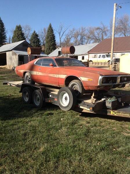

Need new torsion bars for this 340 4 speed rallye

im doing a stock restoration and I'm needing advice for a great vendor that sells quality factory torsion bars! Thanks!
