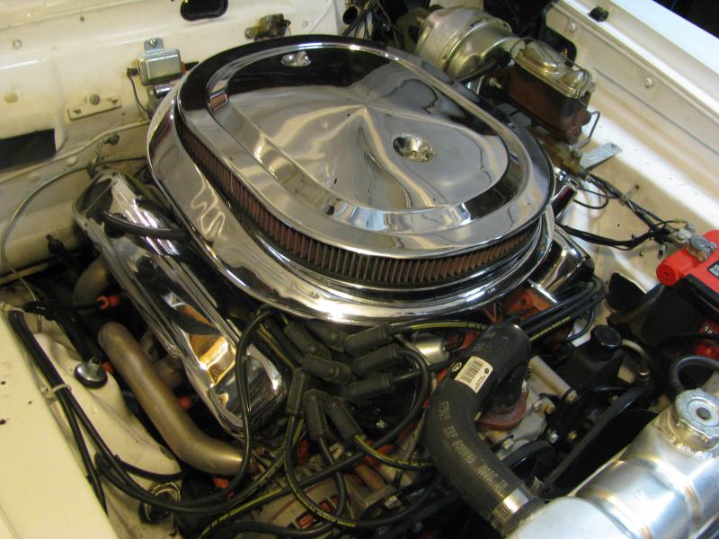

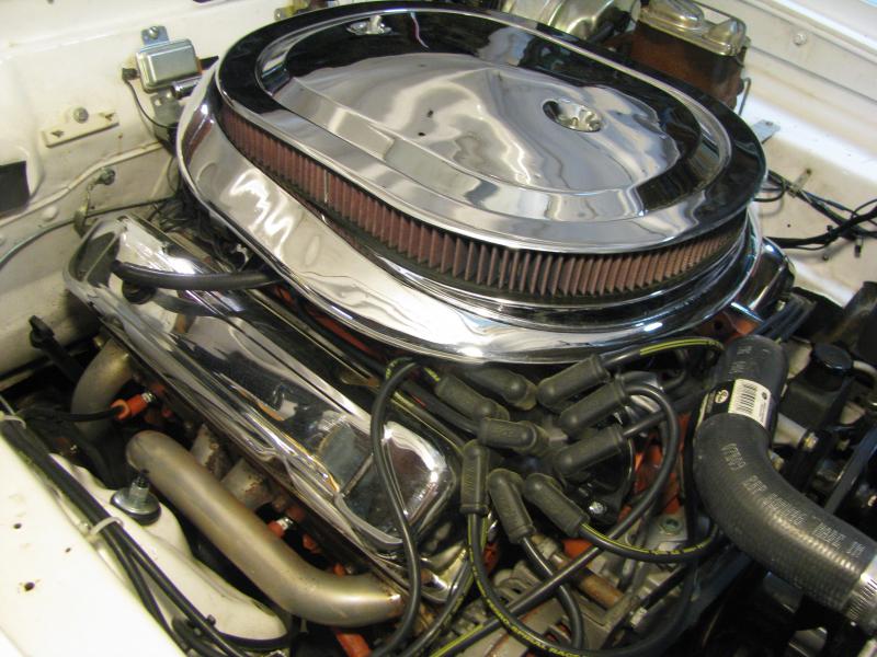

I have the MSD Street Fire cut-to-length on my car and they worked out really well but as stated above why not grab a set of Taylor Boot Protectors. they come in different colours (I just grabbed what was on the shelf)
Here's a pic of them on my car

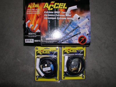

I took your recommendations and ordered the Accel 9000 plug wires (part # 9045c). Amazon had the best price at $116 with free 2 day shipping. Will keep you guys posted.
Let us know how they fit. I may get some if I have issues with burning the boots on the MSD wires.
I found them for $99. somewhere, I think Summit. I ended up using 4 - 90*, 2 - 45*, and 2 straight ends. This kind of sucked because single wires cost $20. each. Maybe with your headers one kind will work though.

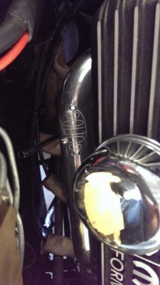

Update: I installed the accel spark plug wires with the ceramic boots (accel 9000). There are a couple things I wanted to point out:
1) accel sells the wires that are precut for Chrysler BB. The lengths are all spot on.
2) they do work well but my only complaint is that there is no 'snap' when attaching to the spark plug. I had a hard time telling if they were secured.
3) these boots are wider. If you have a problem with clearance with rubber boots, these ceramic ones will not fit at all. I have aftermarket headers and could not slip the boot on cylinder #5
