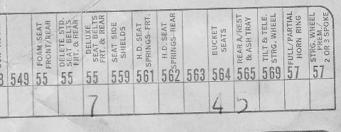

When you mentioned the 573 code for the 3 spoke wheel I went back to my B sheet. Well on the third row on right 3 spoke is in one of the boxes 2 boxes say 57 and the 3 , I bet would be in the box below the 57 with the 3 spoke
it's blank! I'm now sure the wheel was dealer installed.
