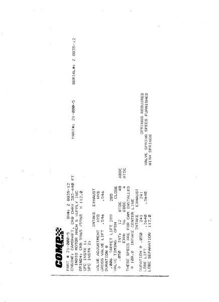

This is the cam that was in the first build. 112 lsa, 241 @ .050, gross valve lift .546. This one had 190 psi cranking pressure. I see on the card it states that these specs are for the cam installed @ 108. intake centerline.

Good advice, I need to take a step back and slow down. When I get a Holley Street Dominator in my hands I will do a compression test before taking the intake off. Then, what do I need to check the cam position while the motor is in the car and the heads are still bolted on? I see on the cam card that the spec numbers are for the cam set at 110 lsa even though it is a 114, so maybe it isn't that bad of a mismatch.

you can not change LSA on the cam once it's made,your just changing the installed center line.
190 cranking compression is not high for aluminum heads it's actually on the low side
Not sure why they even changed the cam to one with a wider LSA, and installed at 112 according to the build sheet?
Maybe that would have helped with the original higher compression pistons?
It seems like the original build should have been good, and maybe the distributor problem was causing the detonation, then things got changed?
I really don't see an easy fix to get the engine to where you want it with the cam and pistons installed?

I'd would just put in an inexpensive Launiti Voodoo 268/276 (226/234 @ 0.050" duration) cam in. The Voodoo cams are 3-bolt so you wouldn't have to changing the timing chain set. It won't make the most top end power, but put the power back in the lower RPM range.

At this point, with under 10:1cr and aluminum heads, I’d say just cam it for the intended usage(like there was never a pinging problem), and see if that provides a satisfactory result.

toss this around. same grind that you have from comp. lobe intake 5964, lobe exhaust 5984. intake=231 [email protected] with 560 lift. exhaust 237 [email protected] with 560 lift. with a 110 LSA with 106 centerline. could even put it on 108 LSA with 104 centerline to build more cylinder compression. that's the smallest duration they have with that grind. the voodoo cam would work too but has a lot less lift.
