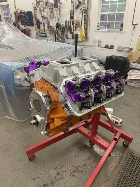

Need some help with a 426 hemi street build

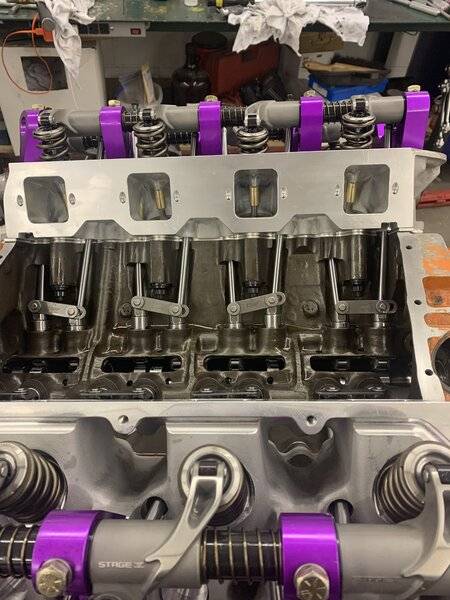

ATI on everything... looking good so far. The mechanical fuel pumps are just heat sinks for vapor lock, so my .02 would be an electric. Don’t skimp on pushrods, they’re a mile long.

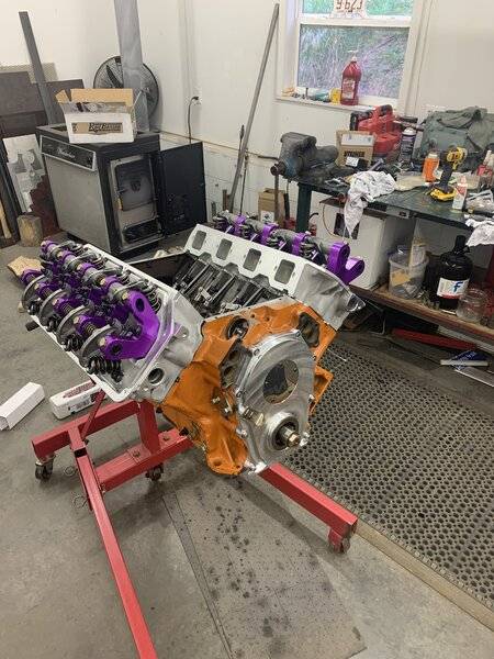

Well the beast is coming together now:thumbsup:

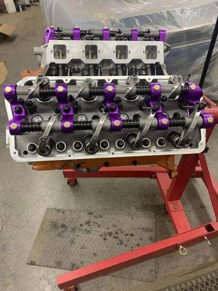

I seen them hit on the outside flats of the covers. Oversize retainers and / or springs.
Haven’t checked them yet waiting on gaskets I will be using ones that look exactly like factory covers but they are taller.
How much taller those covers? Longer tubes I presume? Who makes them? Thanks!
installed height of the springs is 2.154
the OD of them is 1.510 and the retainers
are 1.340
they will be close im sure but they clear these

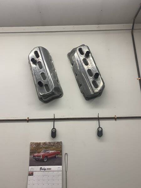

They're probably taller in the exhaust area, that won't affect tube length. I kick myself for selling a NOS pair of those Mopar valve covers with single plug inserts and 4 chrome oil cops $240 dumb.
That was cheap! I have single plug inserts for them as well they are hanging below them in the pic
