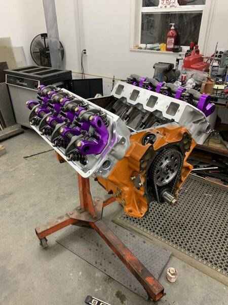

A little more progress. Got the cam indexed and set the heads on to measure for pushrods.
