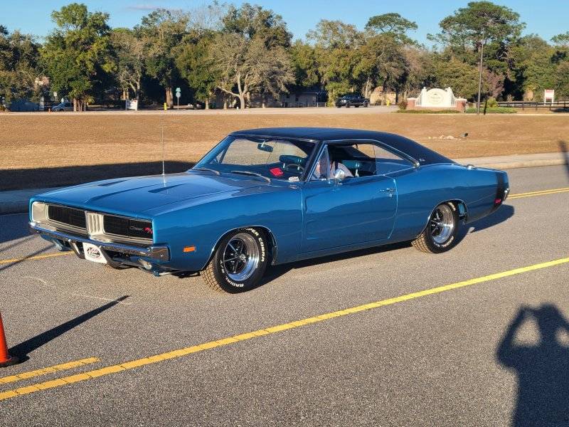

So a little over a month ago I bought a 1969 Dodge Charger RT. It’s the car I've been dreaming of since I was 15 years old. That was 54 years ago. At least that's one thing off the bucket list! LOL
Picture 1 is the day I got it. The first thing I did was raise the suspension back up to stock height, Picture 2.
I was advised on this forum that I should have the alignment redone. I had also noticed that there was a slight vibration in the wheels when I was over 60 mph.
So today I took it in to have the alignment done and the wheels balanced. What did we find out but that 3 out of the 4 Magnum 500 wheels were not true. So, it's time for new wheels!
To me, nothing says late 60’s, early 70’s like Chrome Crager Super Sport Wheels and raised white letter BFG radials!
From what I have read here on the forum, it seems like 275-60-15 rears and 235/70/15 fronts is the consensus for good handling and looks.
So my question is, what are the specs (width, offset, bolt circle, etc.) I need for the wheels to properly fit those tires on my Charger?
For extra points, let me know if you know of the best online place to buy said tires and wheels.
Thanks to all of the experts!
I’m learning every day.
