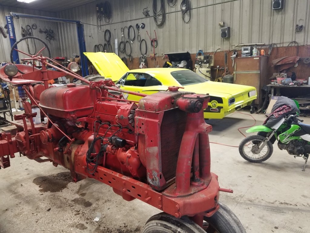

Farmall-International Harvester made the H from 1939 until 1955. It changed little and was extremely popular due to its reliability. This one is all original (not sure the year early fifties I think) except for a new paint job 20 years ago. Mechanically it's never been overhauled. Probably neglected is a better term.

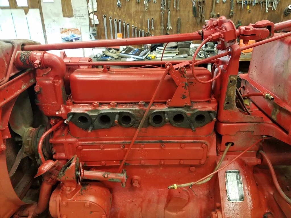

I've removed the tin (which is in good shape). First order of business is a good power washing. Radiator, valve cover, oil pan ect.

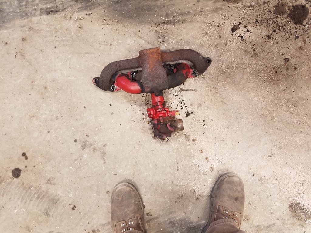

Got her cleaned enough. Now time to remove the carb and manifold. (It's a single manifold). Pretty simple compared to my other project. (Notice the beautiful '70 with the C-Stripe in the background).

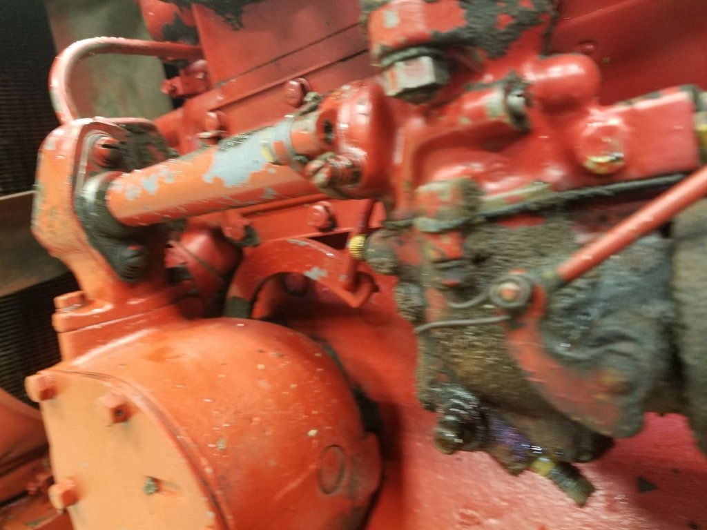

Side view of the carb and governor. Simple removal a couple bolts and linkages. Governor a bit more but nothing that needs explaining to a Mope.

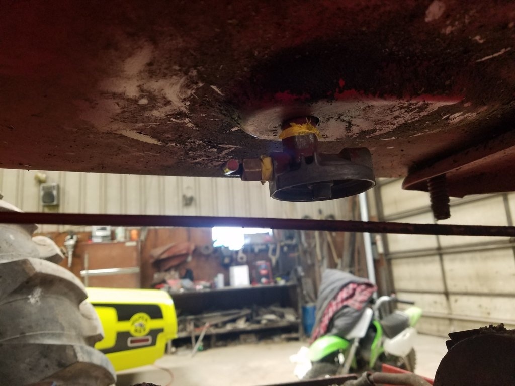

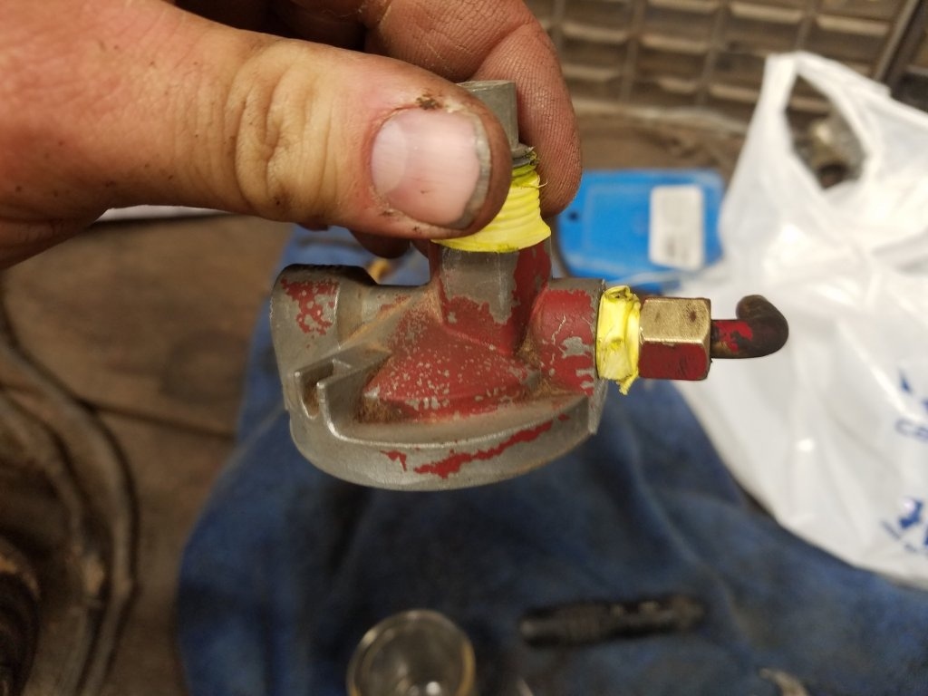

After the carb/manifold areremoved, now it's time to remove and inspect the sediment bowl. These tractors have an update carb but no fuel pump. Fuel system is gravity fed via fuel tank being higher than the carb. Very simple yet effective. Love these old tractors!
Pretty self explanatory again. Remove the sediment bowl unhook the fuel line to carb and then the housing will unscrew from bottom of tank.
This thing leaked pretty good from both the sediment bowl and at the carb. While I'm waiting on my parts I will disassemble, clean and reassemble sediment bowl.
Some of the pieces of the sediment bowl assy are brass. And some are cast aluminum. I applied some specific thread seal tape after cleaning to see if this will help.

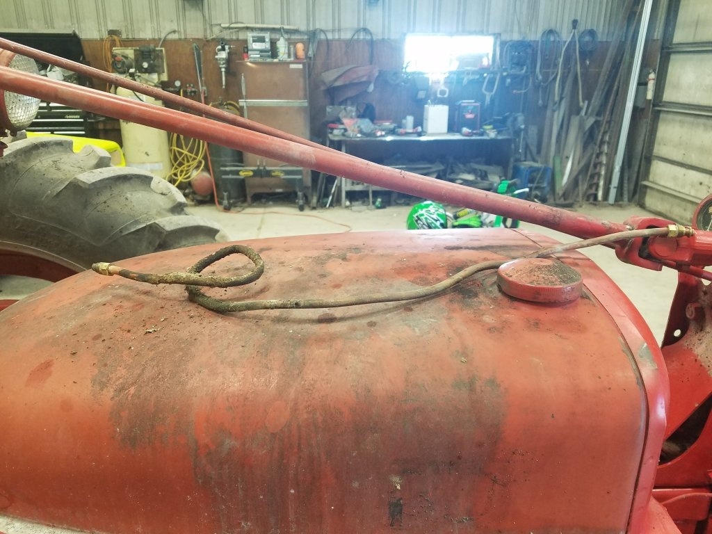

I'm also going to reflarend both ends of the copper fuel line. Or maybe just replace.

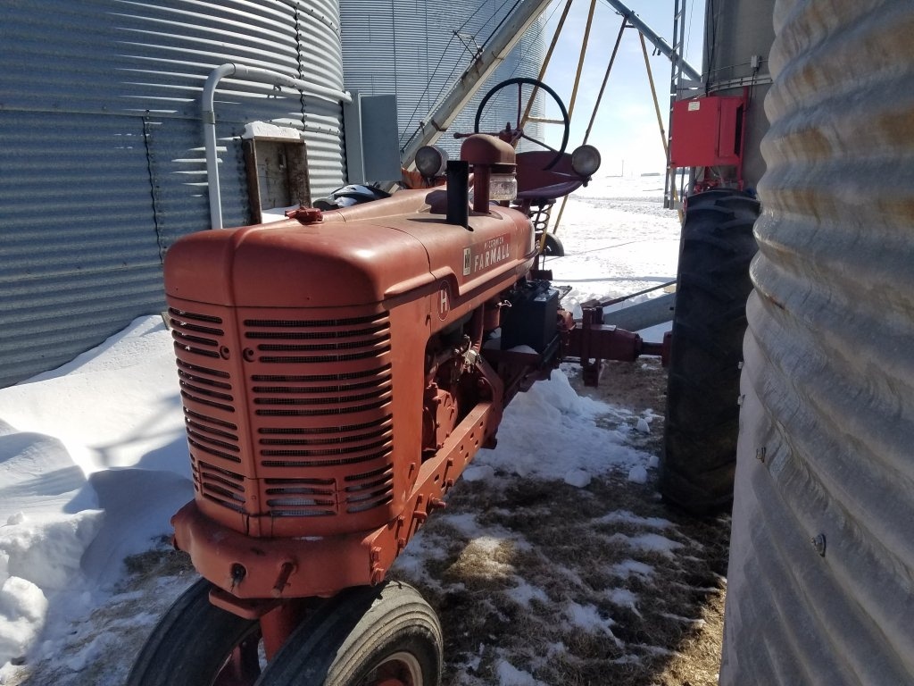

This old girl does stationary work with an auger. And do tight utility work. She can turn really tight and has a short wheel base. She probably get 100 hrs a year.

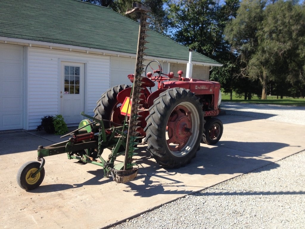

Use to belly mow with it, but switched to an Allis Chalmers WD about 20 years ago. the WD has a handclutch (a precursor to live pto) and 2 way hydraulic.

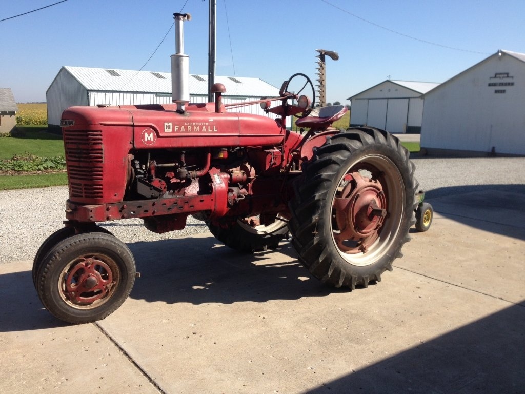

Still use our old M to mow ditch banks. With power steering, you can't beat them for backing wagons.

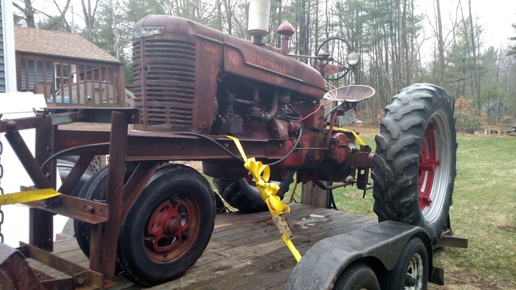

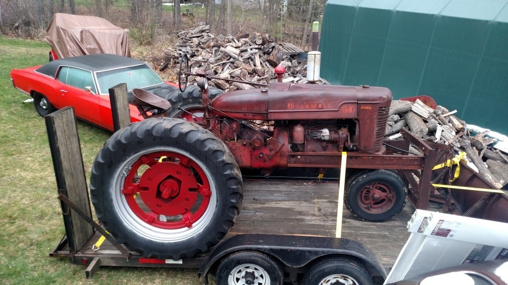

heres my M, also never been painted except for the wheels. i kind wish they werent so i wouldnt be compelled to do the rest of it, but can have red wheel and a rusty tractor, ill get it beautiful someday. which isnt hard to do, farmalls are hands down the best looking tractors out there you can see how massive it is with a full size car trailer and a big *** monte carlo to compared it to.

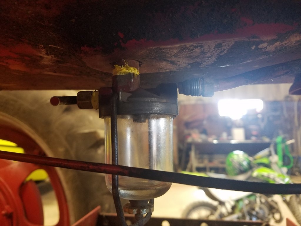

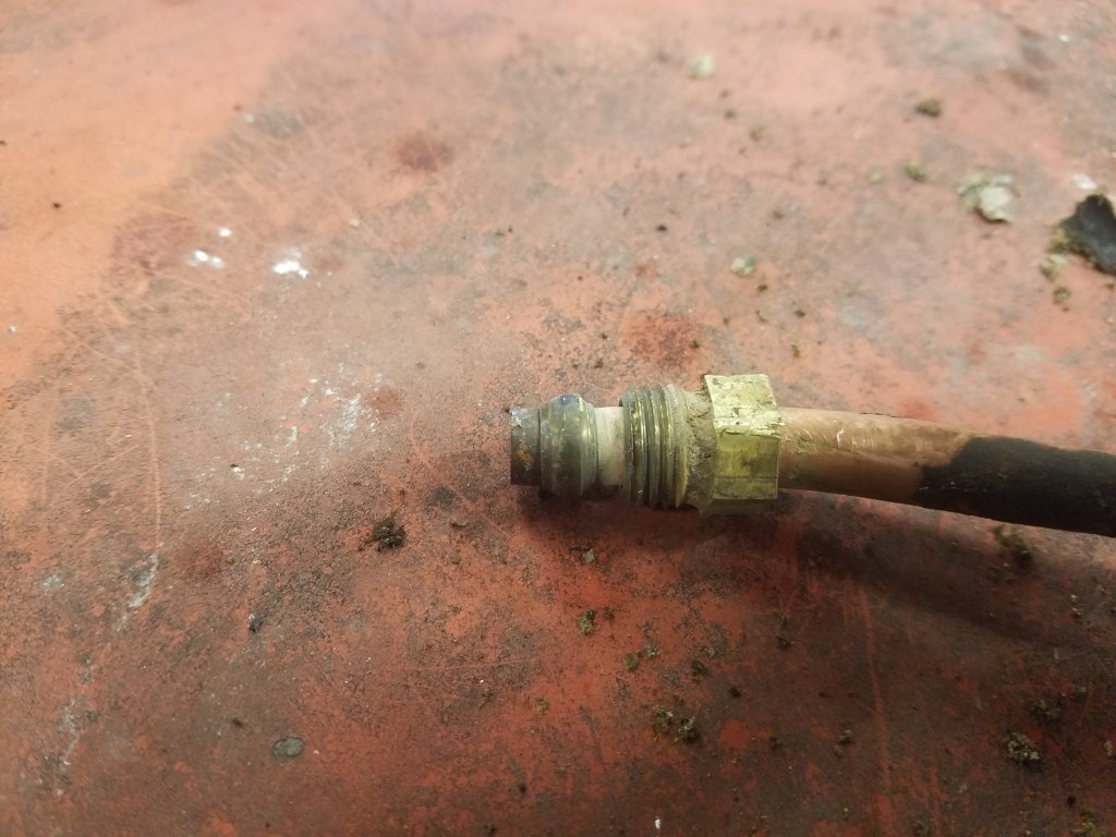

The fuel bowl assy reinstalled now it's time to repair the line.
The fittings on the carb and fuel bowl assy are dual flare. The line is just a copper line with compression rings. Each compression will spin freely be hand. I suspect that may have been the cause of the leaks.
There is length in this line yet. I'm going to cut the ends off and reflare them..tonight...

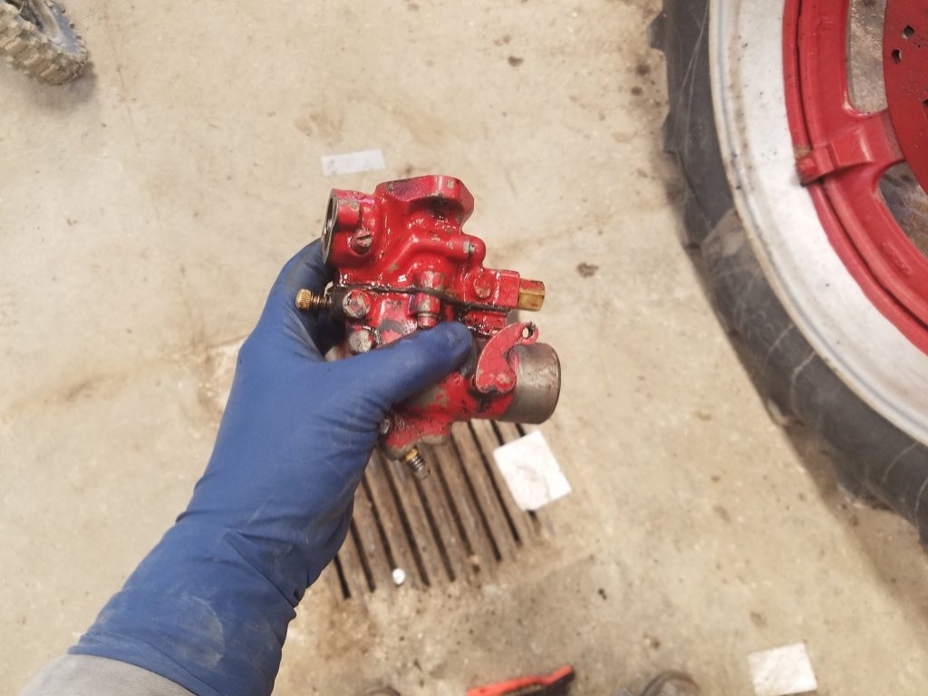

I clean the carb off. I won't disassemble the carb until I have the rebuilt kit.
Is it OK to soak the carb, (submerged in gas)?
