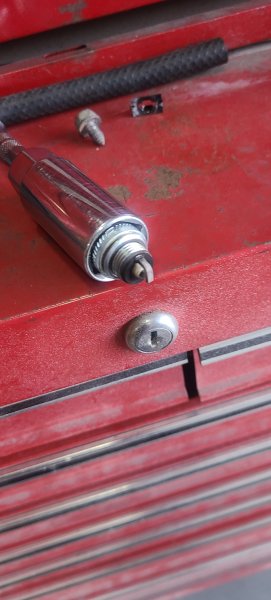

I have AFR approx 13.8- 14.2 at idle. Light throttle running in the 12's. When mash pedal I get between 16-18 AFR. plugs are light grey to dark white.
Obviously im having issues getting fuel and/or ignition timing right. Leaning more to fuel delivery. I'll list what I have done so far for these symptoms. Am in need of help from some pros.

What heat range of plug? Looking at the picture I am guessing you have to hot of plugs and need to rejet the carb.
Well I can put in autolites and re jet or put that brawler back on. Also dump the mech pump and run and run an elec. Have it all in hand.

Look at your plug part number..champion gets colder with smaller numbers. Champion and autolite plugs come in different heat ranges. Just switching brands in itself you may not change anything. Compare electrodes on the two plugs if they look similiar they are the same heat range. Too hot of heat range can make it like it is pulling a plow, really, really hot it can cause detonation from the electrode glowing red... and it can completely flame out and die in some situations. It's where I would start before you get to switching carburetors. At least tell us what range of plug you have for starters.
