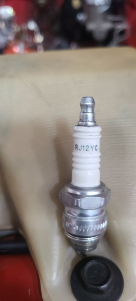

Look at your plug part number..champion gets colder with smaller numbers. Champion and autolite plugs come in different heat ranges. Just switching brands in itself you may not change anything. Compare electrodes on the two plugs if they look similiar they are the same heat range. Too hot of heat range can make it like it is pulling a plow, really, really hot it can cause detonation from the electrode glowing red... and it can completely flame out and die in some situations. It's where I would start before you get to switching carburetors. At least tell us what range of plug you have for starters.
What would you recommend for plugs then? I'll pull 1 and get part number. Cheapo champion...lol
