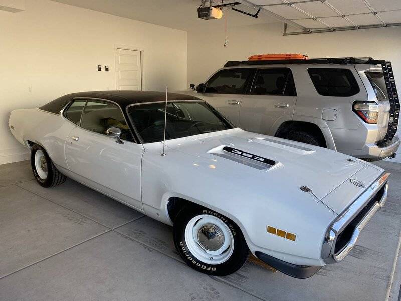

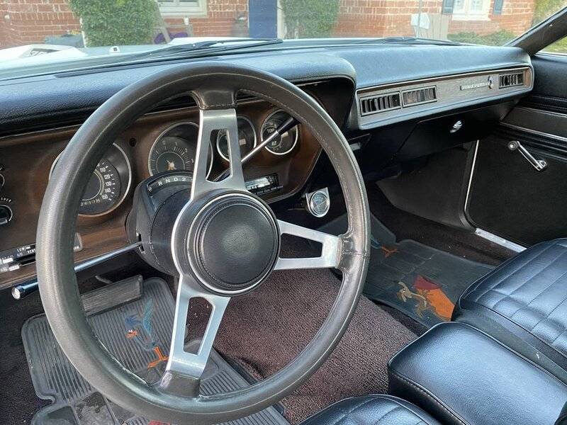

Well…. It’s mine. Feels weird leaving it. Not driving it home 500 miles. Lol. Hope to get it shipped next week some time.
6811E20C-26AB-46EF-8305-2063D5A062AB.jpeg 81E301D2-32DF-4AA2-B102-E0CA00FD0BBB.jpeg
Has a few things that need fixing.
Heater core
A/C needs at the least all new lines(prolly way more than that)
Windshield wipers don’t park when you turn them off (have researched here that it may be the switch)
At some point during its life most likely when it was painted recently someone looks to have welded up the road runner emblem holes. Really would love to put it back the way it was. Been trying to find measurements.

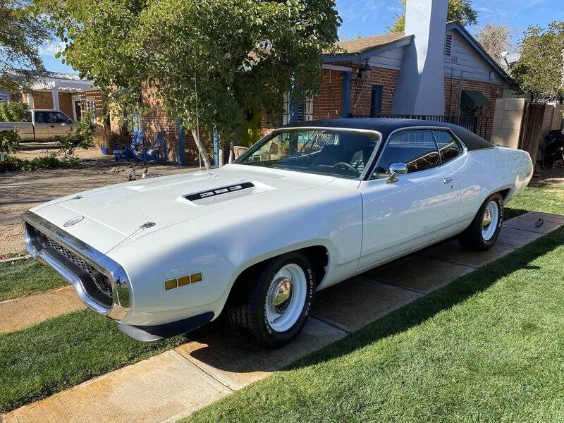

This car was indeed for sale in the Goodyear, AZ area back in September. It had steel wheels on it then. The Rallye wheels were included with the sale. I guess the dealer removed the steel wheels and kept them?
I considered going to look at it but decided not to.

No clue on the steel wheels. I believe it has been moved thru two parties since those pics. The interior has been redone, trunk pan done and the rally’s installed.

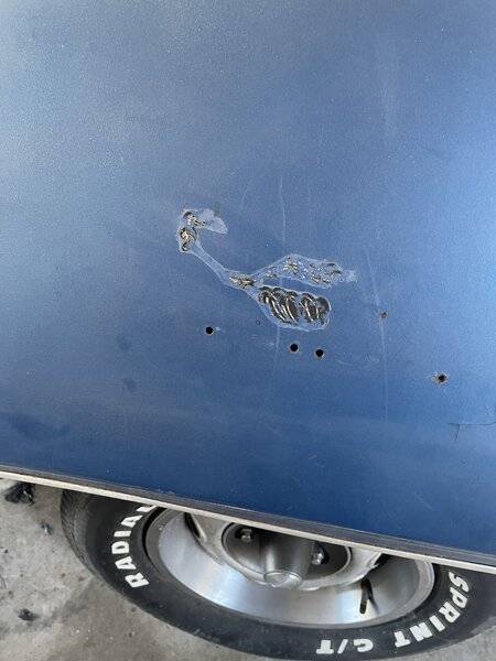

Sir. If you don’t mind and can give me some dimensions on where yours were located it would be awesome. I have the emblems and decals ordered but then realize I still only have a general idea of where they go.

Here ya go. DECAL > front edge of decal is 29 1/4" from front edge of qtr panel, lower edge of dust trail is 5 1/2 " above bodyline of wheel opening. Name plate > front is 28 5/8" from front edge of qtr panel, lower edge of letters is 4 5/8" above bodyline ofwheel opening. NOTE: bodyline ofwheel opening, NOT the edge where the wheel opening molding is.
