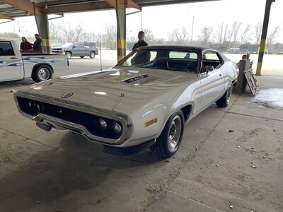

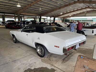

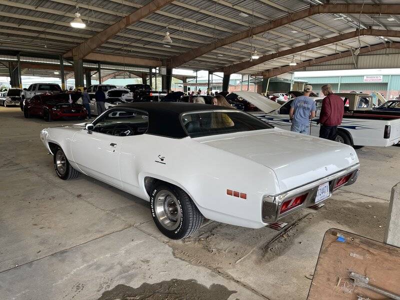

New 71 Plymouth Roadrunner owner
Dealer should cough up those white steel wheels and load them with it. They were already painted to match that car. Good luck with your new purchase.
Never even asked about them. Not my style. The rally’s are perfect. I still believe the car went thru another person between it for sale on Craigslist and the Texas dealer.

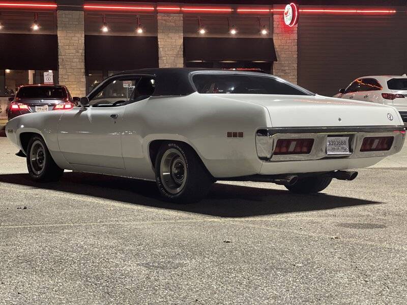

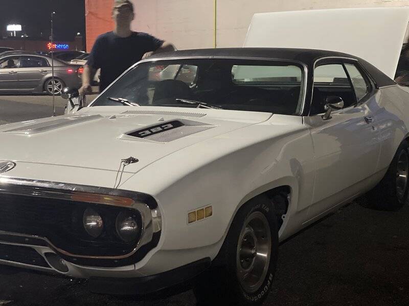

Wednesday night last minute Thanksgiving supply run.

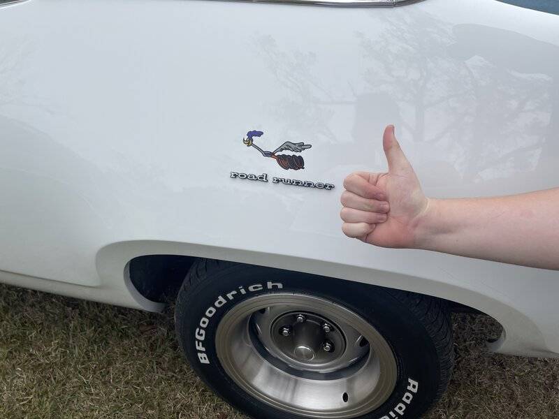

Thanks for the help with the measurements on the emblems and decals. Got them installed yesterday. Now I hopefully will stop getting the “Hey man. Hey. Is that a Baracuda?” at the gas station. Lol.
Here ya go. DECAL > front edge of decal is 29 1/4" from front edge of qtr panel, lower edge of dust trail is 5 1/2 " above bodyline of wheel opening. Name plate > front is 28 5/8" from front edge of qtr panel, lower edge of letters is 4 5/8" above bodyline ofwheel opening. NOTE: bodyline ofwheel opening, NOT the edge where the wheel opening molding is.
Thanks. Measurements worked out great.
You're welcome ! I'll add this understatement, with those rallys, your car looks freakin' great !!
