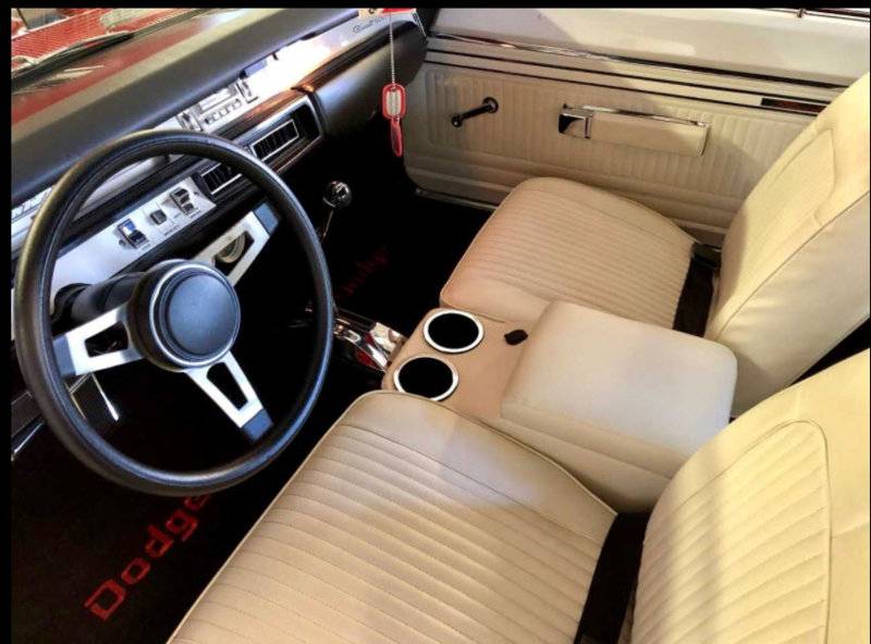

An interesting new product. They don't tell you that you will have to get something to the equivalent of a Hurst Floor Shifter to make it work. It does come in a lot of colors!
https://bluethunderautomotive.com/product/mopar-b-body-console/
I like it,to bad I bought a buddy seat. Dont think the color would match do to so many different whites over the years.

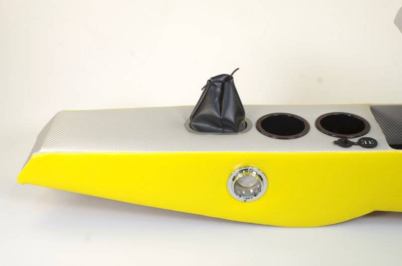

I like this too from their website:
I may get the big part black, with yellow highlights, or all black, or some combination.

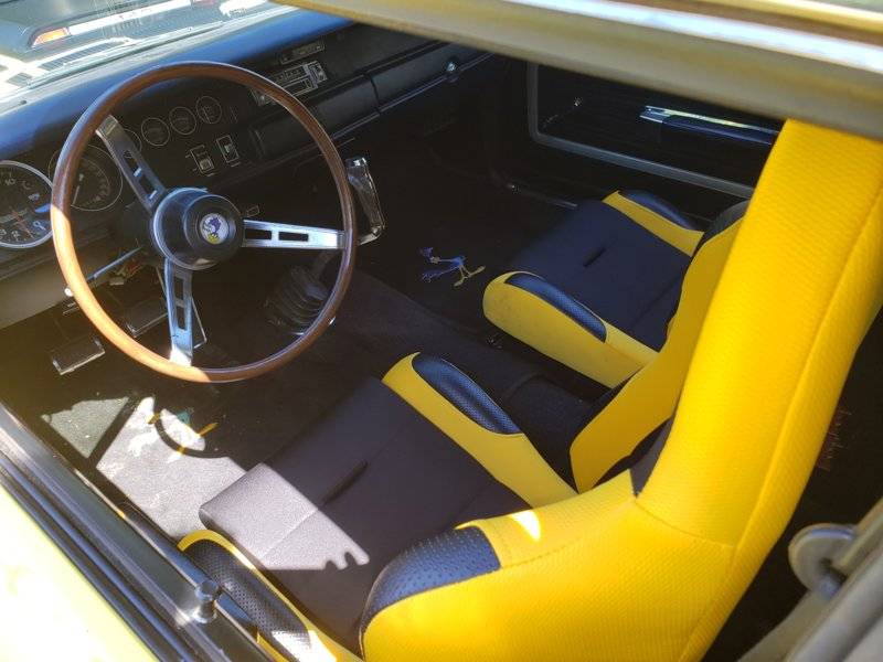

My current interior:
So I have exchanged some emails with this company. They are sending me a swath of the yellow in the picture above and a "carbon fiber yellow".
I was SO excited about the lighted center console pictured above in yellow that I missed the caveat that it was only for automatic transmission, floor shift. It looks like the shift boot would let it work, but I am waiting to hear back.
Anyway I think something good will come from this, and I think ultimately I will wind up with a console like this one and compatible with my floor shift standard transmission. Color(s) or black to be determined.

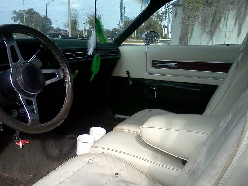

I fastened two PVC pipe couplings via two each rack equipment mounting ears (one long, one short) to the front of my buddy seat to get two coffee cup size cup holders.
https://www.ebay.com/sch/i.html?_fr...mount+ears.TRS0&_nkw=rack+mount+ears&_sacat=0
Available colors are a slightly off white (plumbing pipe) that matches my 1973 interior quite nicely, and gray (electrical pipe), if you have a black or darker interior.
The screws that secure the first bracket to the seat is hidden underneath so the cup holders can be removed leaving no visible evidence.
IIRC the pipe diameter is 3"
I already had the rack ears, so my total cost was about $6.
They actually match better in person, plus I have new seat covers since the photo.
...and I cut a slot in the top front for a coffee cup handle.
I get a LOT of comments on those, and people are almost always amazed when they figure out (or I tell them) what they are.

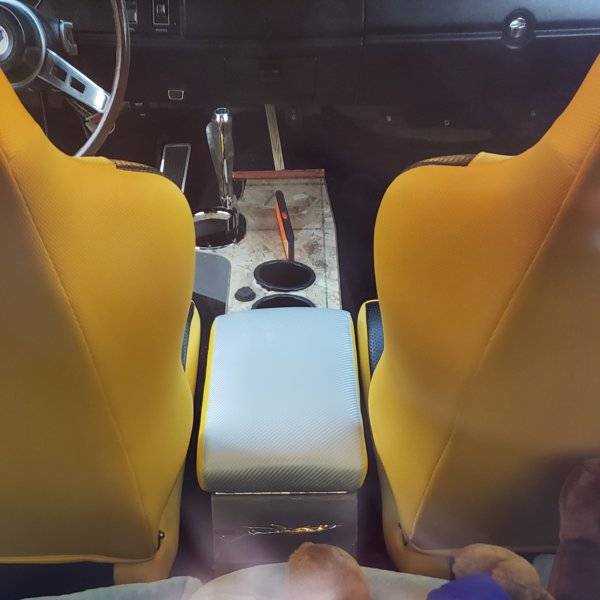

I positioned the prototype console that Blue Thunder sent me.
To be clear, the one on their website that I first saw I initially thought would work for a no console, BENCH seat shifter that, like others, have removed the BENCH seat and replaced it with bucket seats, in my case aftermarket (SCAT Procar) seats.
As a reminder, it's this one:
Well it turns out that READING the online description says this console fits an AUTOMATIC FLOOR shifter.
So they sent me an unfinished prototype to measure, modify if needed (it needed) take measurements, pix. etc.
So I took a lot of time and effort and did that, cut and trimmed and even reduced the height of the boxed in area that's covered (between the seats) and I'm sending it back to them to make a production version.
I am very excited about this, and IT IS DESIGNED TO WORK WITH THE STOCK Hurst pistol grip BENCH SEAT NO CONSOLE shifter. That means not having to source any pay HUGE money for the console shift lever with the giant C shaped bend in it.
No pix of the prototype until I have permission.
I will follow up again.
So I spoke with the Blue Thunder rep I have been working with about the prototype manual transmission console that they sent me. He said I could post a picture, but I am limited to the one I am posting here.
I am very excited about this and I welcome feedback! Keep in mind this is an unfinished product. In the finished product, the shift lever hole will be moved in the direction of the passenger side (3 o'clock) for clearance of the stock bench seat no console shift lever.
