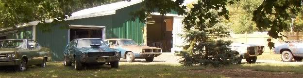

I went 32' X 54'. 32' is deep enough for a full truck to be in with ample room on both ends, and the 54' I took 14' from for office / bench area and mezzanine. This basically left me with a 32' x 40' shop. I bought retractable air hoses as I hate rolling them up and did all the electrical in exposed conduit. You can not have enough light either, plan for adding on if you can't afford it right now. I can have three projects sideways in 32' and one in the doorway bay. I can even have one into the workbench area totaling 5 in the shop at a time. That's too many (maybe!) but the excess room is nice. Here is a link to a thread about it. I know I could have easily used more space, but I'm very happy with the layout. However as said above, "It will be too small!" no matter what you build.
http://www.forabodiesonly.com/mopar/showthread.php?t=180423&highlight=gdrill
