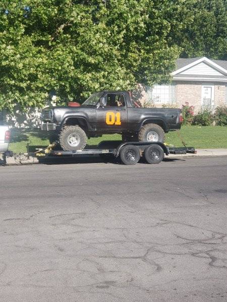

Max effort dirt and mud drag racing vehicle. Looking for information on total timing. 528 cubic inches, aluminum heads, 12 to 1 compression, team G open plenum intake 1250 holley dominator..630 ish lift howards solid roller cam, roller rockers. Msd 6al with stock distributor. 727 trans with trans brake and 4500 rpm stall converter. Running 38 degrees of total timing right now, seems sluggish of the line but screams at the end. 110 vp race fuel NGK viewer plugs gaped at .45. Total timing question asked as I try to get to know Mopar. Thanks
Welcome,I set mine at 34. any pics?

4.56 in the rear, 4.11 in the front. We run low range though. 38 inch tires in the rear, 34 inch in the front. 4500 stall on trans brake, actually closer to 5000. Distributor is not locked, just do timing above 3500 so all mechanical is in play then. Brand new damper from 440 source. Yes 38* I timed it with a dial back to zero light. Yes cam is installed 4* retarded on purpose.
