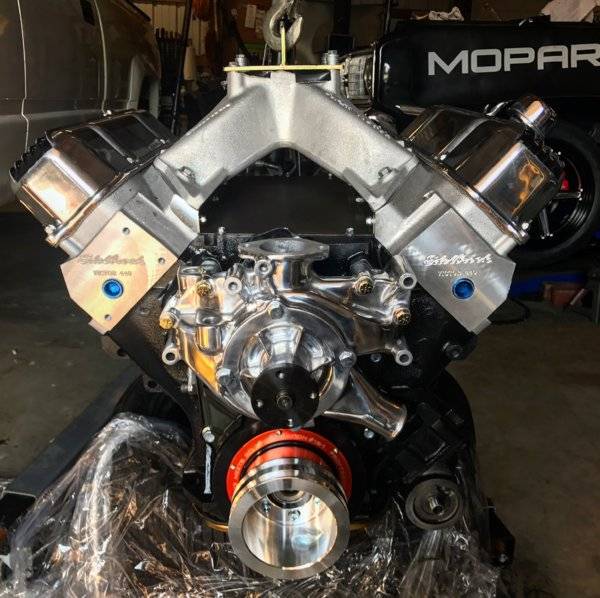

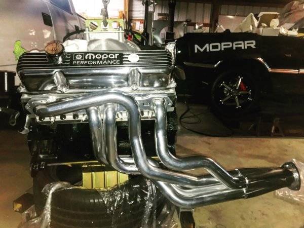

Can you Estimate my horsepower?
I've been a busy boy. The car is such a sleeper with the stock style air cleaners. The motor is just about perfectly tuned. I'm jealous of my friends car. Time to start on my 1964 330 post car.
Is it done? If so how does it run?
The motor is assembled, but not in the car yet. We’re thinking 750+Hp
FE6F3690-034B-4CB5-84B9-52BC28CC2FE4.jpeg 84F98A76-1C83-4450-B54F-698CB3C2D91E.jpeg
Tell me some interesting things about the internals. Cam compression etc. etc.
Mahle -8cc pistons, eagle rods and crank, 12:1cr, cam is 296/303 .690/.691 solid roller BAM lifters, ferrea valves, fitech 1200 sitting up top.
