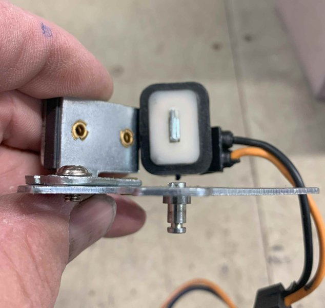

Car is a restoration project, everything new/rebuilt. Stock 1974 mopar distributor, stock coil, Ehrenburg Hirev 7500 ECU/ballast resistor, new quality ignition switch. Would not fire while cranking, but would start running after I let go of the key and returned to run position. I could unplug the starter relay trigger while it was running, turn the key to start, and it kept running fine. After all of the typical testing/diagnosis I took out the distributor and looked at the pickup coil closer, as you can see it is rotated, not aligning vertically with the reluctor and produced weak signal. It is a Standard LX-102 from Oreilleys. Looking at it from the side it was bent a little too, so I straightened it up when I installed it. I did not notice it was also rotated.
So I suppose we all need to open the boxes and look at all new parts closer now right there in the store since half of them are just complete crap.
I replaced it with a NOS pickup coil and plate assy. I found on flea-bay and it works perfectly now.
Thats what I thought the problem was too, but turns out the combination of weak pickup coil signal and ECU being backfed through the ballast resistor during start mode caused no fire!
