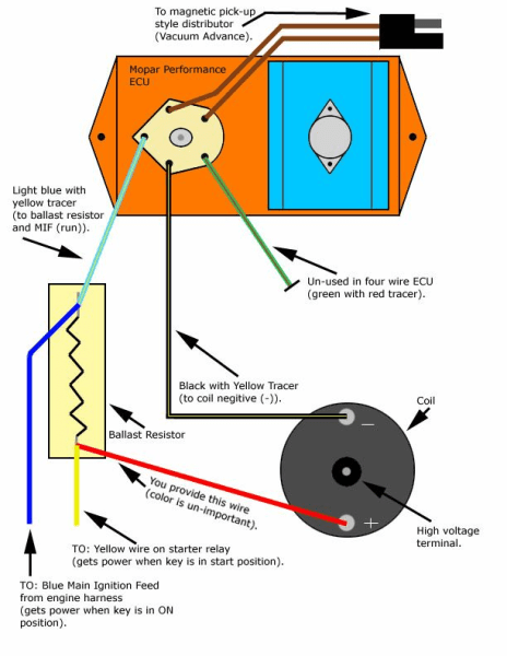

There is 2 circuits one for starting and one for running. If you put a jumper wire across the ballast and it solves your problem then the run wire is dead.

Every time you replace a Ballast Resistor , you are removing wiring connectors , reconnecting , moving cleaning connections
I have seen more bad connectors , resistance in the wiring , then actually bad Resistors or ECUs
Start at the bulkhead connector with your meter , then move to the Ballast Resistor at the actual wiring connectors themselves then onto the Ballast Resistor male spades
Then to the positive side of the Ignition Coil , same thing

See if you can spot the errors in the link you provided....
