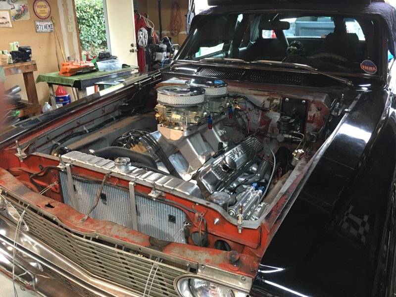

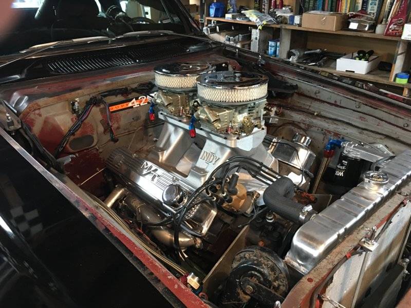

.650 roller , 10-1 , stage 3 heads , 426 marine block bored .010 over , gear drive , etc. but because the cars not an original max car, and with a modern sheet metal style tunnel ram, a fairly large gain in power will be had..and i have always wanted a tunnel ram..plus i now can run just about any valve cover , with the crossram i was very limited..
I don't think the standard Max wedge scoop is gonna work, lol.

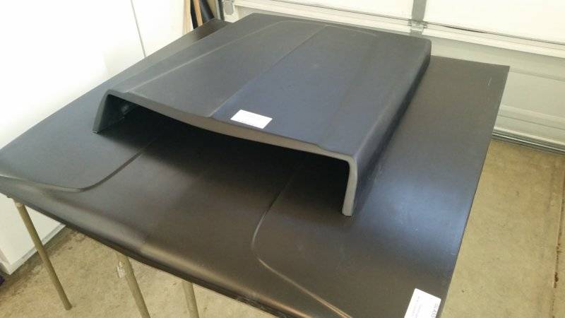

yeah,,the max style scoop is for sale! with those air cleaners on,, its above the hood by 4".. not bad,, so i might install a 4 3/4" vfn hood scoop (sc-115) like the 1 run by malex currently..or, let it all hang out the hood..
intake is 1" taller than the indy crossram bathtub unit,and according to hot rod magazine dyno tests makes appx 50 horses more than 1.
I don't know how much better the tunnel ram is than the Indy cross ram. I do know that on a engine similar to yours I dynoed a Indy cross ram vs the stock cross ram on the same day. The Indy was better starting at 4000, 50hp better at peak, and had peak power at 6800 vs 5800. I'm sure you'll pick up.

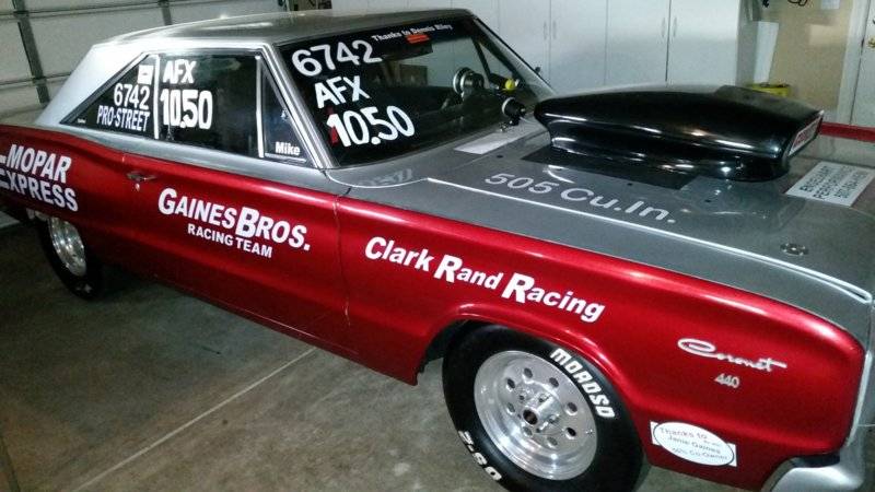

I know the tunnel ram won't make it under my 5" scoop. Front carb is to close. I tried a stub stack with the INDY intake. Didn't like the carb opening that close to the bottom of the scoop, killed .10. My motor is slightly higher than stock though.
Doug

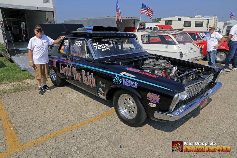

after cutting the hole in hood,,i set it all on and measured,4",i did not set motor height with the plate,that was done before i got the car,,there is a '63 plymouth called "keepin the faith" that is running this intake , dual 4's and is using the 5" tall max scoop..running mid 8's!
after cutting the hole in hood,,i set it all on and measured,4",i did not set motor height with the plate,that was done before i got the car,,there is a '63 plymouth called "keepin the faith" that is running this intake , dual 4's and is using the 5" tall max scoop..running mid 8's!View attachment 676508
I know the car. Paul Habura, used to race against it way back. The motor looks pretty low in the car. With the Indy my front airhorn is level with the hood. But the 5" tall portion of my scoop is well forward of the carb.
Doug
