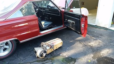

Had a window in the weather and I found out you can indeed get the case out from under the dash. I already had the radio and Clock out for repair, console had to be slide back also. No wonder these cars weight 3700 lbs, that case has to be 40 or 50 lbs by itself. The heat control valve is frozen, several nipple are broken off the vacuum switch, also on that switch ,I believe the ones that supply current to the compressor clutch look burnt. I'm assuming when I take the case apart I'll find the H valve frozen also. Hopefully the vacuum actuators aren't bad.
