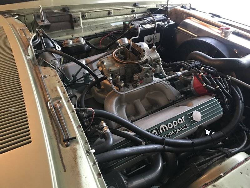

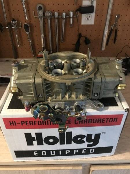

ok ok, I'll get you some pics when I get home today. :D
Ok, here’s the pics. Current set up and new toy.

Check the idle speed and vac. in and out of gear with the engine warmed up to operating temperature *prior* to removing your old carburetor. This will give you a baseline for the new unit. Also make sure to pull the carb after a few head cycles and double check the base plate to main body screws. Enjoy!
