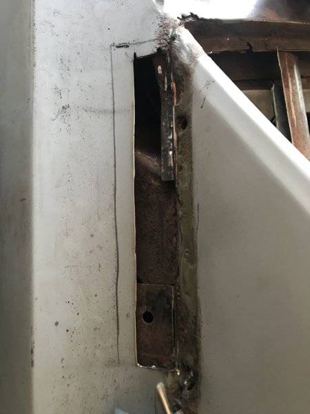

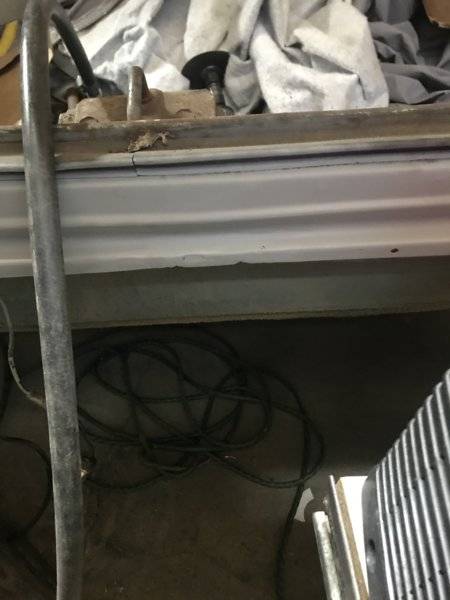

Well today I was trying my hand at welding.. I'm not a welder by any stretch. So I fixed the rusted sail panel but I still need to get the upper portion welded. However here is my progress.
Lincoln 140
Speed set at 2.5
Power at A
.025 wire
75/25 argon.

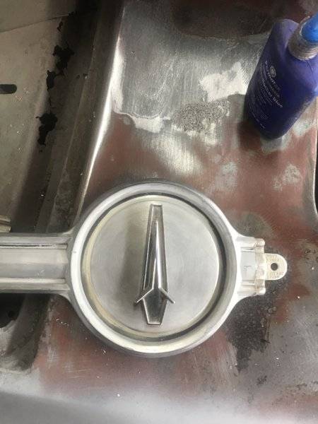

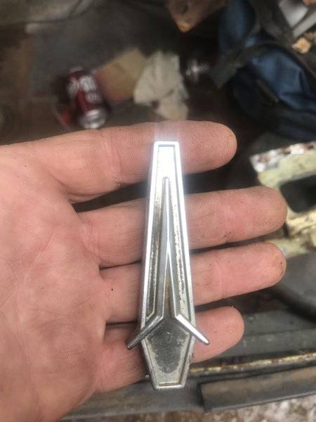

And on another note.. I found my missing emblem in the trunk pan of the parts car above the gas tank. Broken off but repaired.
Bag and tag everything, you deserve an award for saving on of our Mopars from the scrapper. keep up the good work,Patients is the key.

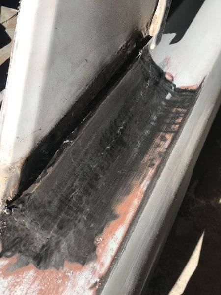

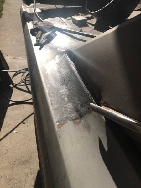

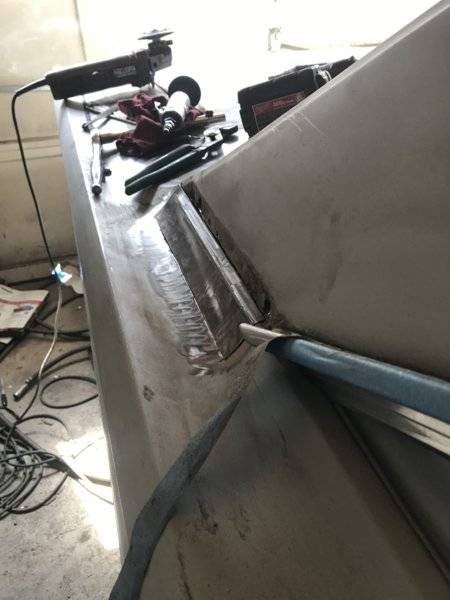

Today working on the small bumper filler lip 2 rusted spots to patch in.. Hand making the patches not too hard to do.

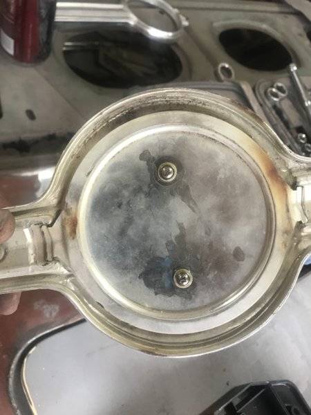

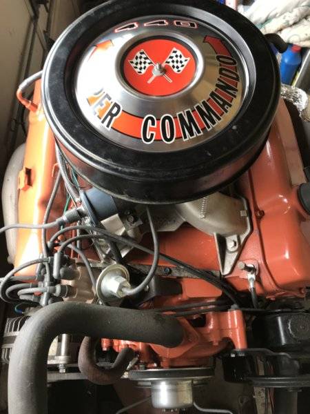

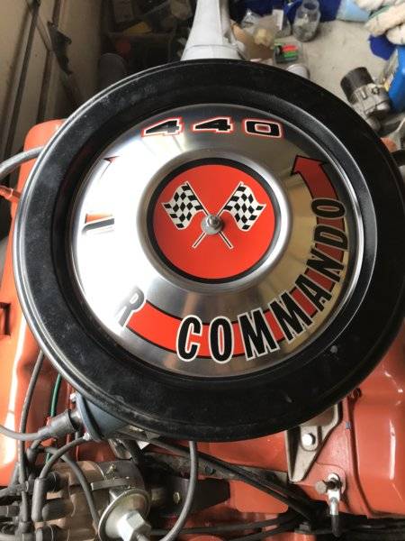

Im planning on an engine repaint to a more appropriate turquoise Its not a 66 engine and not a numbers car so as long as it looks like it should be in the 66 ill be happy. I topped off the engine with my 440 Super Commando pie tin. The engine never looked finished. And yes im going to try and use the HP manifolds.. Hope they fit.
View attachment 749498 View attachment 749499
The HP manifolds will fit, I have 'em on my '66

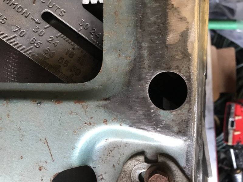

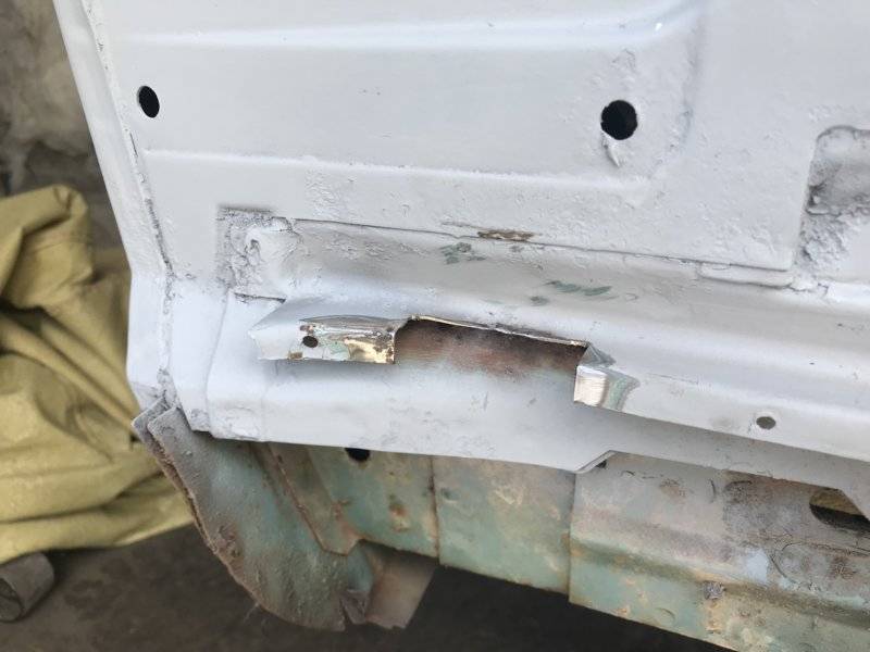

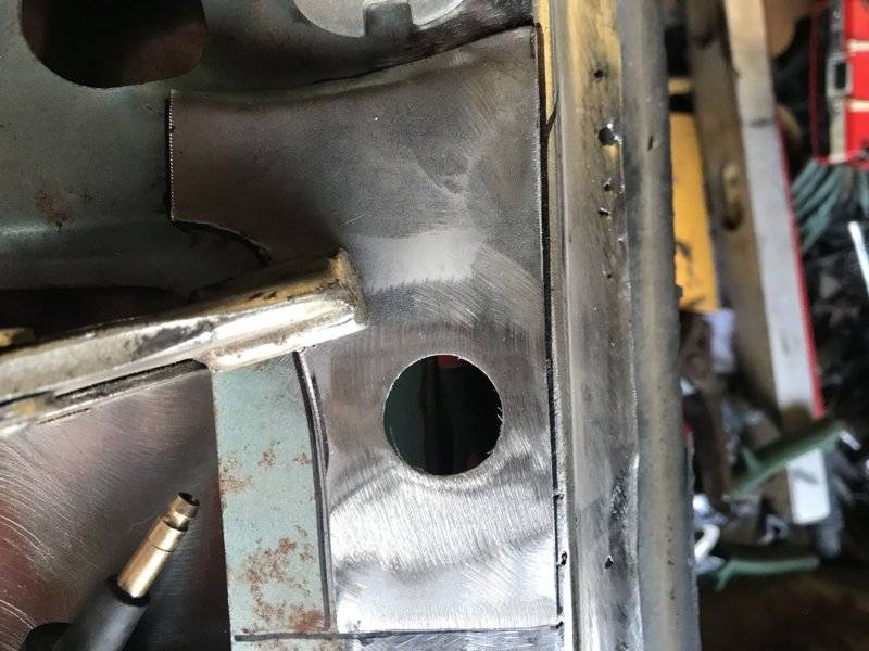

Before and after pics.. Of the small stuff. I suck at welding but got it done.

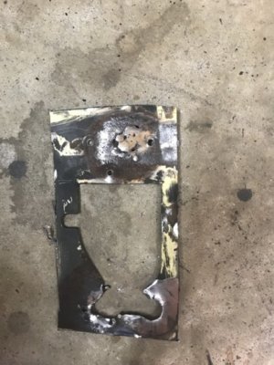

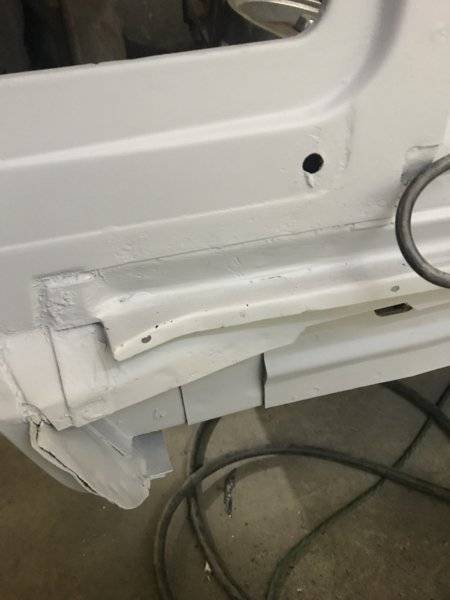

New patch panels being worked on.

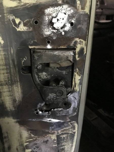

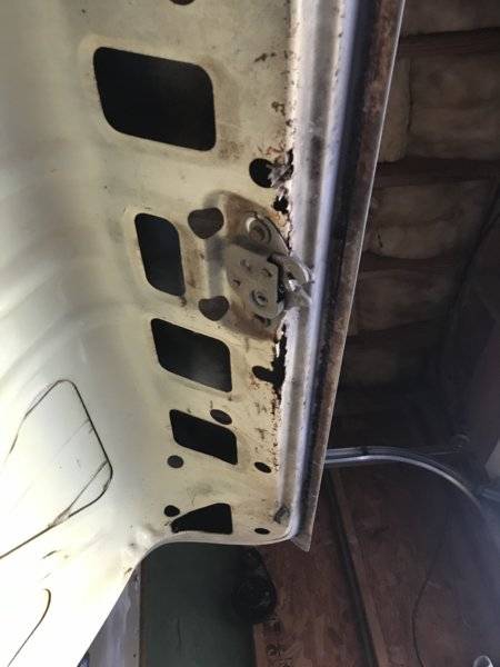

The door latch area.

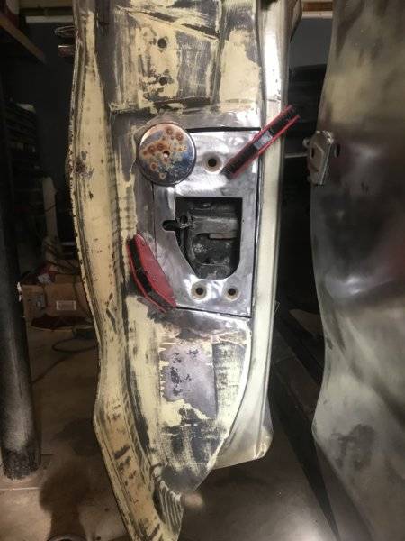

The trunk lock area.
You do nice work.

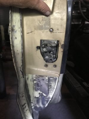

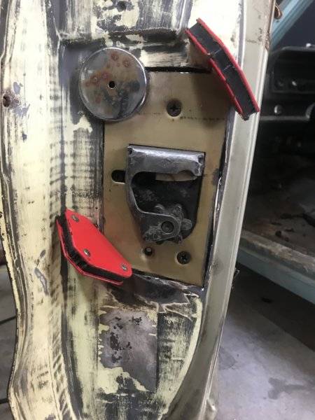

That remains to be seen.. But thanks.. Updated the door latch need more damn argon/c02 but I have the patch panel cut out and resized. Then on to the trunk lid.
FYI the harbor freight magnets suck.. They barely hold anything.
