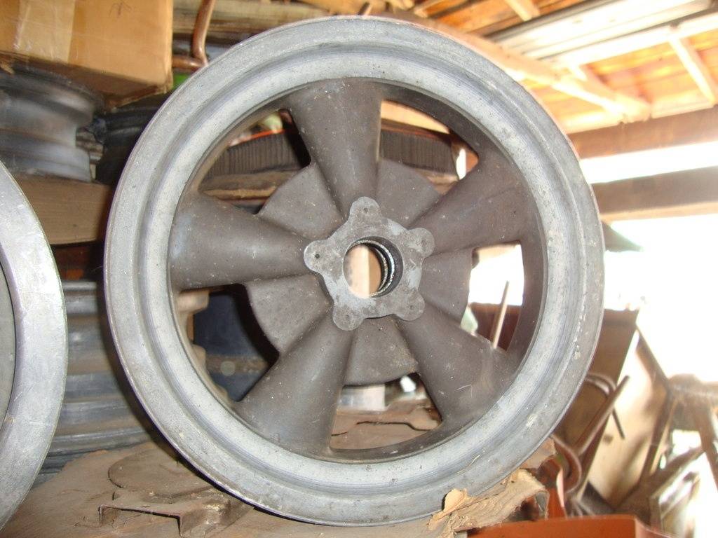

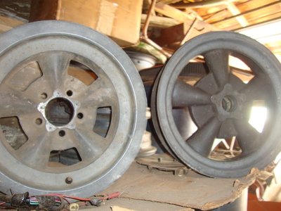

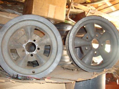

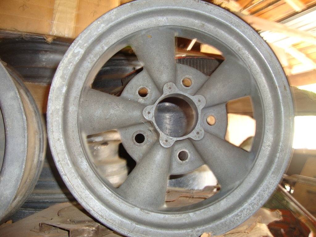

so your ghoing americans on the noise like the factory light weights came with , 15x4's were that , not wide enough for street driving , got 4's for mine 63 , just race or show with them , 6's for the street . here is some americans two 4's n 6's .

Pizza cutter wheels and tires look neat but are not a good idea on a heavy street car. For sure at least a 6" wheel on the front. Depending on your use of the car, you may or may not need to change out the t bars. If you want maximum weight transfer for a drag car, the /6 bars work great. Not much fun though on a street car with respect to handling.
