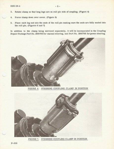

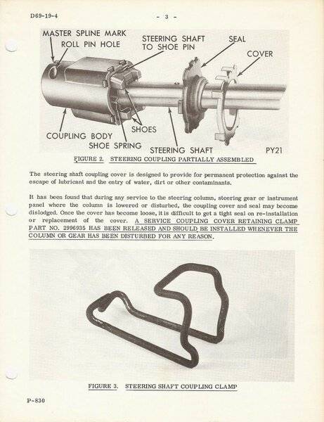

Is there a tool that will crimp back on the cover for the coupling body?
While reinstalling the steering column the cover came off. I’ve tried a large set of channel locks but can’t seem to get it in place.

I solved the cover issue by using one of these steering coupler retainers - about $15 on E-bay.
Those bails work well although I found out it’s a good idea to test fit it off the car first if you can, in case the legs need a little adjustment to snap on without gorilla effort.
Yeah, the stock seal covers are a pita and have only been able to get one to stay on. Trick is to not move the tabs much when taking them off.....and then it's a crab shoot.

I did install the clamp that was recommended. I was able to crimp the tabs after installing the clamp and will see if it stays in place after I remove the clamp.
First. Don’t remove the wire bail , factory came out with this so mechanics at the time could correct your same issue ! And about your replacement steering box , it is very difficult to steer at slow speeds with this 16 to 1 box and no way around it , all though the box is a really nice unit , but a pain in the parking lot to turn , on the move not to bad , is it worth it , you will decide for yourself! Just my opinion of course!
