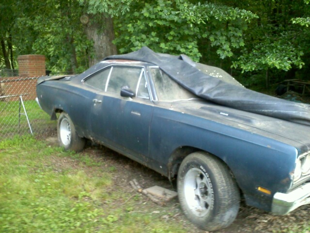

I just bought a 1969 roadrunner and it needs quarters, along with other stuff. Is there any problem with putting the 1970 quarter panels on it and the 1970 grill? I just like the look they give the car.

Even though it's only one year difference, there's more to it than that. But if you are determined to do so, you're really going to create a Franken Runner.
Sounds to me like you should have held out for a '70 instead of jumping the gun and getting a '69.

I couldn't pass this one up original, running, and interior was just reupholstered two years ago (but it does need a dash pad if anyone has one!). It just needs one quarter, has some pin holes in the trunk and under the rear window, and has some surface rust on the roof.

Full Quarters for a '70 won't work because of issues with the fit at the trunk gutters/deck lid and tail panel (all completely different). Grill won't work being a '69 has multi-angles across the front where a '70 is straight. You could graft in '70 quarter skins but then you'll still have a body line/accent line in the '69 front fender and the '70 quarter skin doesn't, but has a scoop. I've seen a couple of '69's on here that someone grafted either the scoop or a quarter skin from a '70 on. Didn't look too bad.... I agree with these guys. Keep it a '69, that or sell it for a '70. Seems to be what you really want anyways.

Thanks for all the welcomes and info. I have decided to keep it a 69! I have lots more questions and will post them as i go along in the build. I have owned only chevys (71 chevelle, 63 c10, 53 210, and a few others) so i hope ya'll don't mind that I will have more questions of what fits, doesn't fit, and little tricks.
